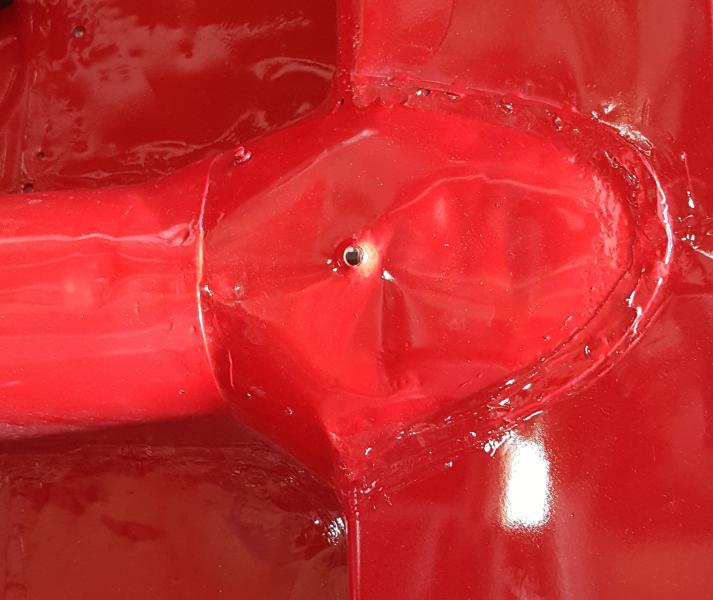

As some of you may recall the body shop has had my car for over three years, they have done a really nice job of painting the car but the way the assembly as been completed is just plain not up to standards, that's what I am saying. I provided the body shop with all the proper bolts and mounting hardware I got from TRF in kits (two kits for each application I double ordered by mistake), I provided detail drawings from an original Triumph parts catalog, and a Moss parts catalog I specifically indicated photo copies of the drawings what bolts were to go where. He says he "lost the bolts along with several other items. The holes in the tunnel are just unacceptable and need to be properly filled and the surface should be smooth.

- In my opinion the holes in the tunnel cover are not "the way they are" and would never be like that on any TR3 with this floor configuration. The welding job, for a professional shop, is not that good.

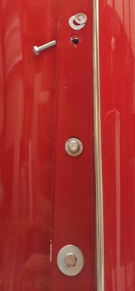

- The bolts used to attach fenders are too long (1 inch length used EVERYWHERE) not only are they not the right length, they look crazy even if they will not be exposed or seen (in the tire well for example they hang down like little fingers).

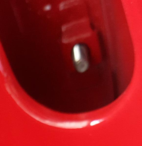

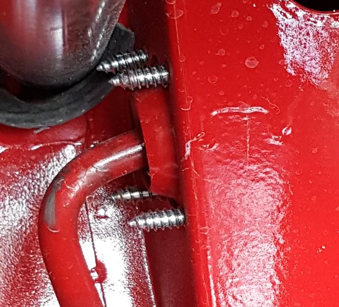

- The sheet metal screws were used to attach the gas pedal assembly to the tub are the wrong size and incorrect type of screw I think?
- The shaft of the gas pedal was bent significantly as well during the installation and has to be corrected in order to work properly.

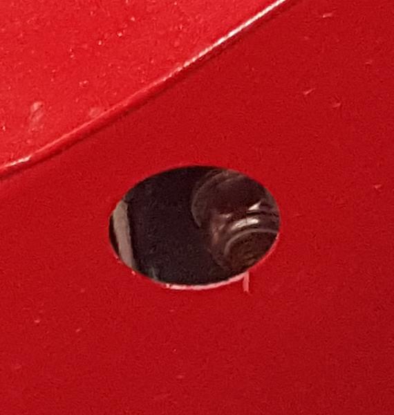

- The tub sits high in the rear and the access hole to the shock levers does not line up properly and the tub was bent to give clearance for the lever to travel up and down.
TR3 Accelerator Pedal Assembly mounting with sheet metal screws (2).jpg76.3 KB · Views: 170
TR3 Fender mounting 3 wrong size and type of bolt (2).jpg21.3 KB · Views: 174
