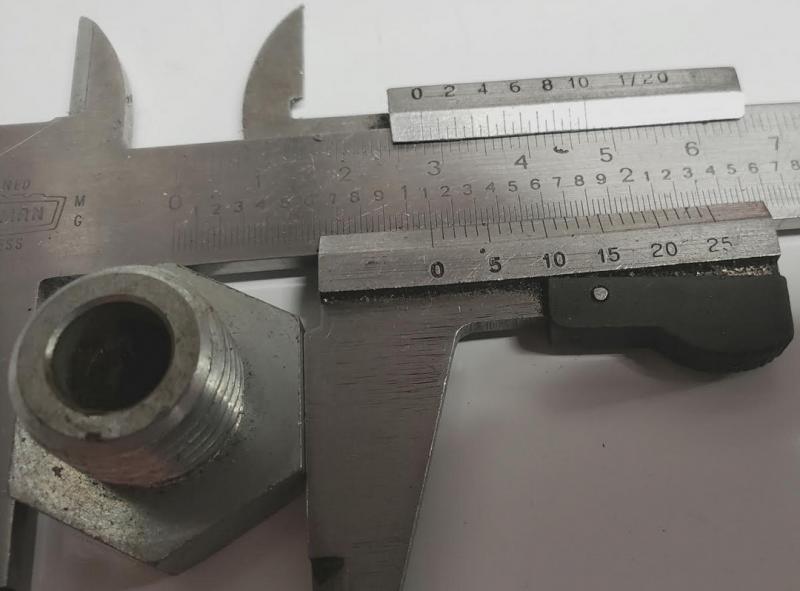

Guys - I bought an aluminum sump maybe 15 years ago. It does not use a stock plug. I had bought a magnetic plug that didn't fit - at time of purchase assumed the aly sump took the same plug. I took the magnet out and drilled/glued it into the new plug.

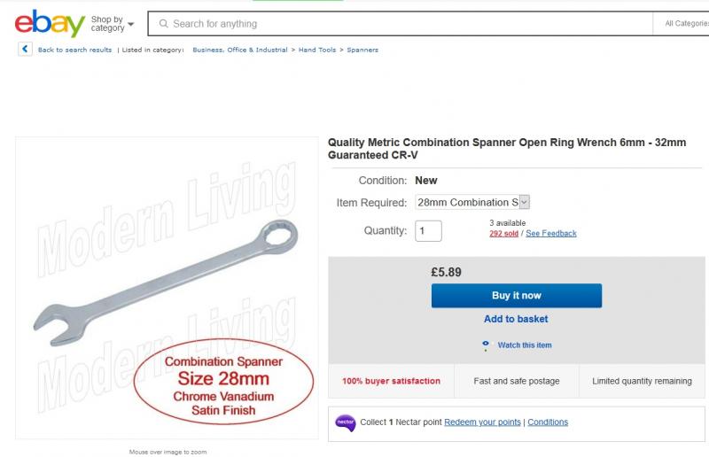

Here's the plug - 28mm wrench:
Here's a spanner from eBay UK; 28mm socket's about the same price:

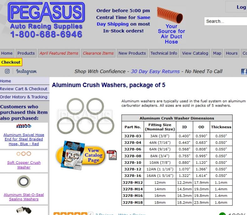

You might try annealing the copper washer, they 'work harden' after several uses and benefit from softening, or get a new one. Also, check for any burrs/mars on the sealing surface of the pan & plug that would prevent sealing.
Thread tape won't help because it isn't a tapered thread, the copper is what seals it.
