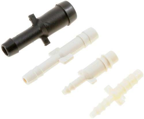

Anyone have any ideas on fabricating this small piece that is bigger at one end than the other. Moss catalogue Ignition/Distributor part # 27. Any McGuyvers out there?

Is just a bit of flexible tubing? Or is that just how some PO fixed mine?

Going by memory here.
I seem to remember using as Tr6 straight vacuum connector (Moss #379-370) and opening up one end with a dill bit to accommodate the fitting at the carb.
M.
Re: Stromberg..."coupler" that links vacuum outlet to diff vacuum line is N/A?
That's probably a better idea; but you could also check at FLAPS and see if they carry something like this
