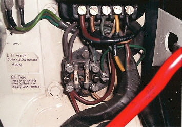

Right. My Triumph handbook states that there should be 35 amp fuses on both sides.
However, when I got the car, there was a Buss 50 amp fuse in the left side and a Buss 20 amp fuse in the right side! I took them out and began this process of trying to discover which fuses are appropriate. I have installed Moss (Lucas type) 35 amp fuses on both sides, with the same for the spares. If, by chance, the RH fuse blows because of an overload (all the normal items plus my electric fan going at one time), I'll just put in a new 35 amp fuse. Some day I'll have the fan fused separately.... or perhaps, as suggested, run it through the LH side.

So, just to muddle the waters a bit, as Geo and Randall know, a 35A and 50A British-standard fuse is called for. P36 of the Instruction book:
Yes, but that is a fairly early edition. Later editions show both fuses as 35 amps. I can't lay my hands on my 4th ed at the moment, but both 5th & 6th show 2x35.
Wow, thanks for pointing that out, Randall. I had no idea! So much for edition 4! Off to see if 2X35 Fuses will work OK in my previous 50+35 car...
I've settled down with 2x35 amp, even with my new electric fan working, and I've had no problems (so far). Lesson learned: don't let a person not familiar with Britsh cars and British electrical systems cars put American fuses in.
