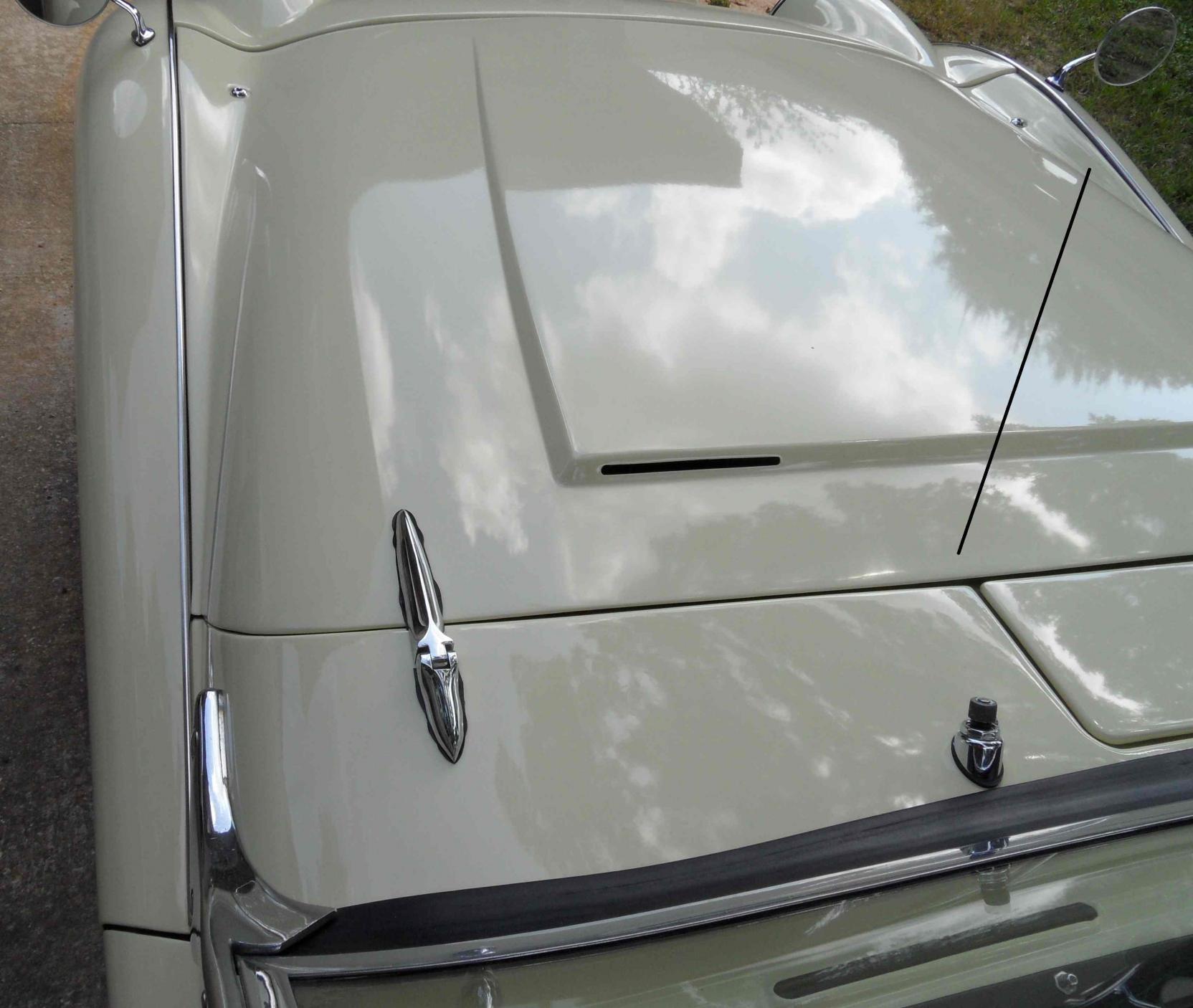

Tush,
When I got my car the hood appeared as if it had been through a hurricane -as it had. Where I have the black line drawn was a upward crease at about 30 degrees. Both the "natural folds" in the hood for the raised section were severely bent. I had no apron or cross brace. When I started shaping the hood, I laid it on the floor, stood on it and bent it closer to position. I ended up with 2 aprons (a small mouth and a large) but neither apron matched the front of the hood. I had to bend one of the cross braces and the hood to match, as well as the top if the apron. I learned to use a hammer and dolly, but I think it was worth the effort. The "fit" to the cowl was adjusted with some lumber cut to the shape (curve) of the cowl, and then hammered/clamped until the support member at the top of the hood matched better.
In all honesty, I thought I had huge gaps on the sides of the hood -until I installed the beads after it was all painted.
