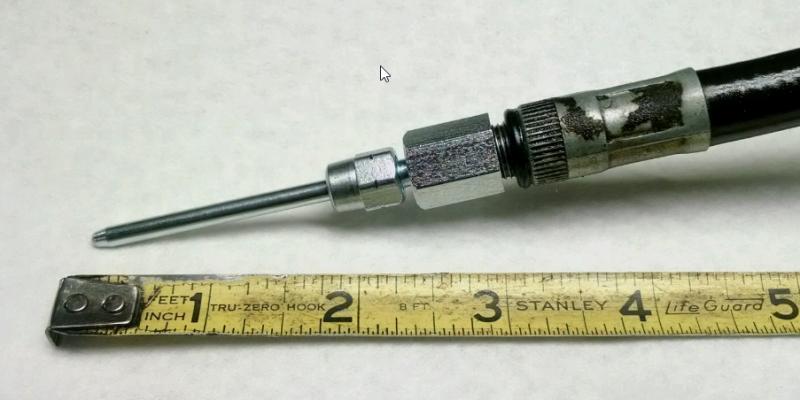

Grease injector makes for easy install of Corn Head grease:
I wasted a fair amount trying to pump the grease in with just the threaded portion on the end of the hose. Air was trapped just inside the box and the grease would bubble up on the outside of the cover. The needle allows injection from lower in the box, allowing the air to escape.
