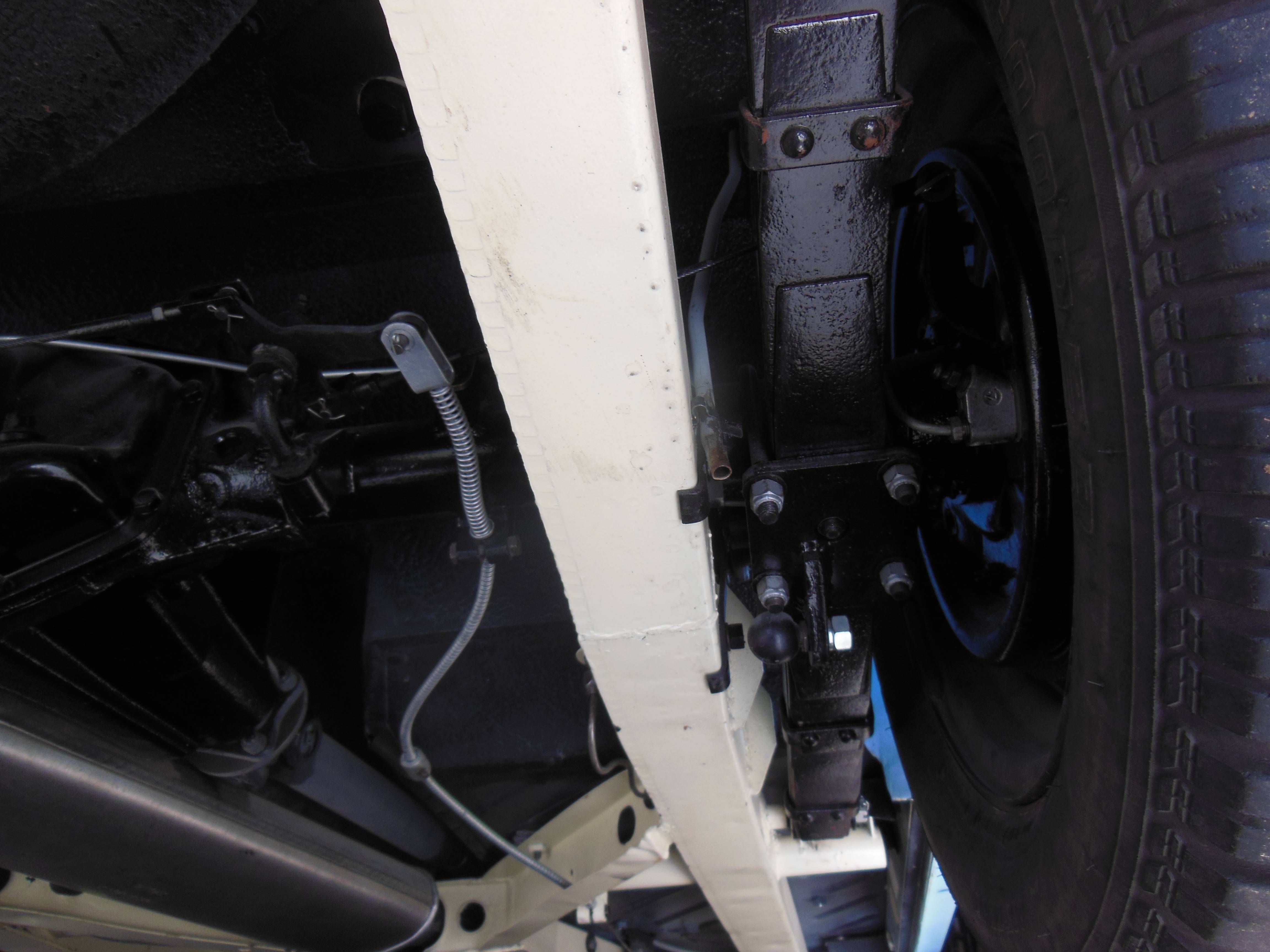

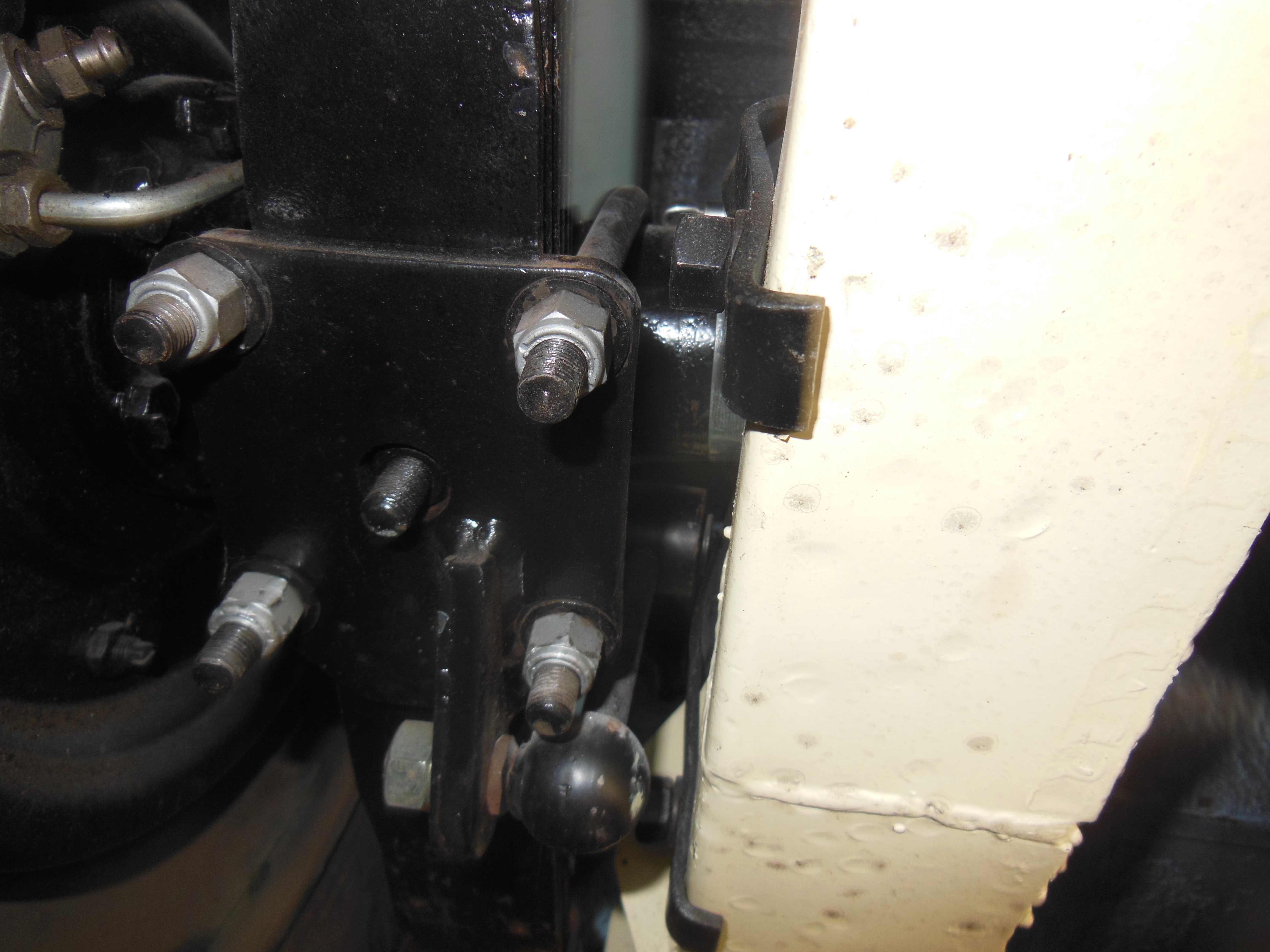

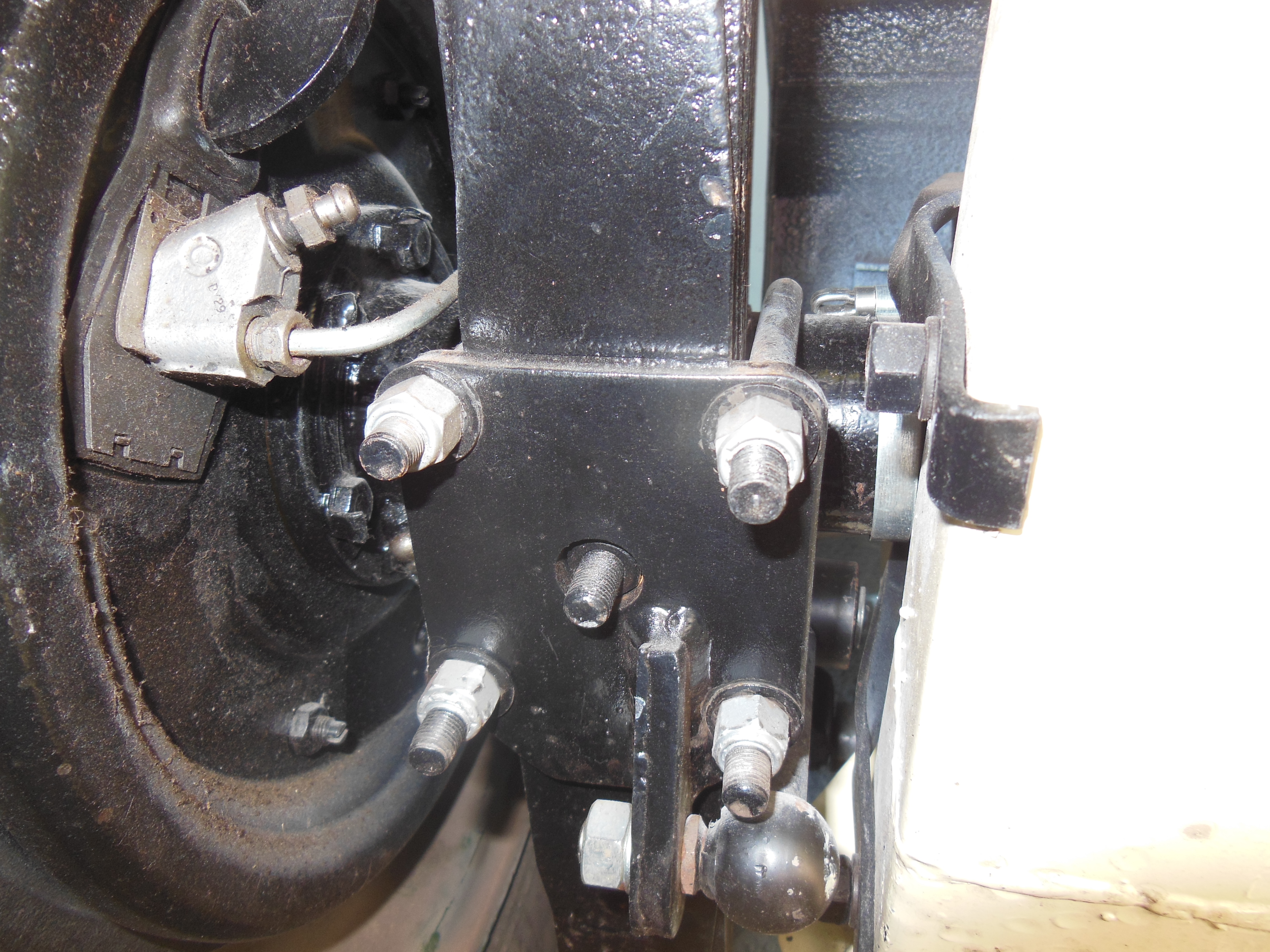

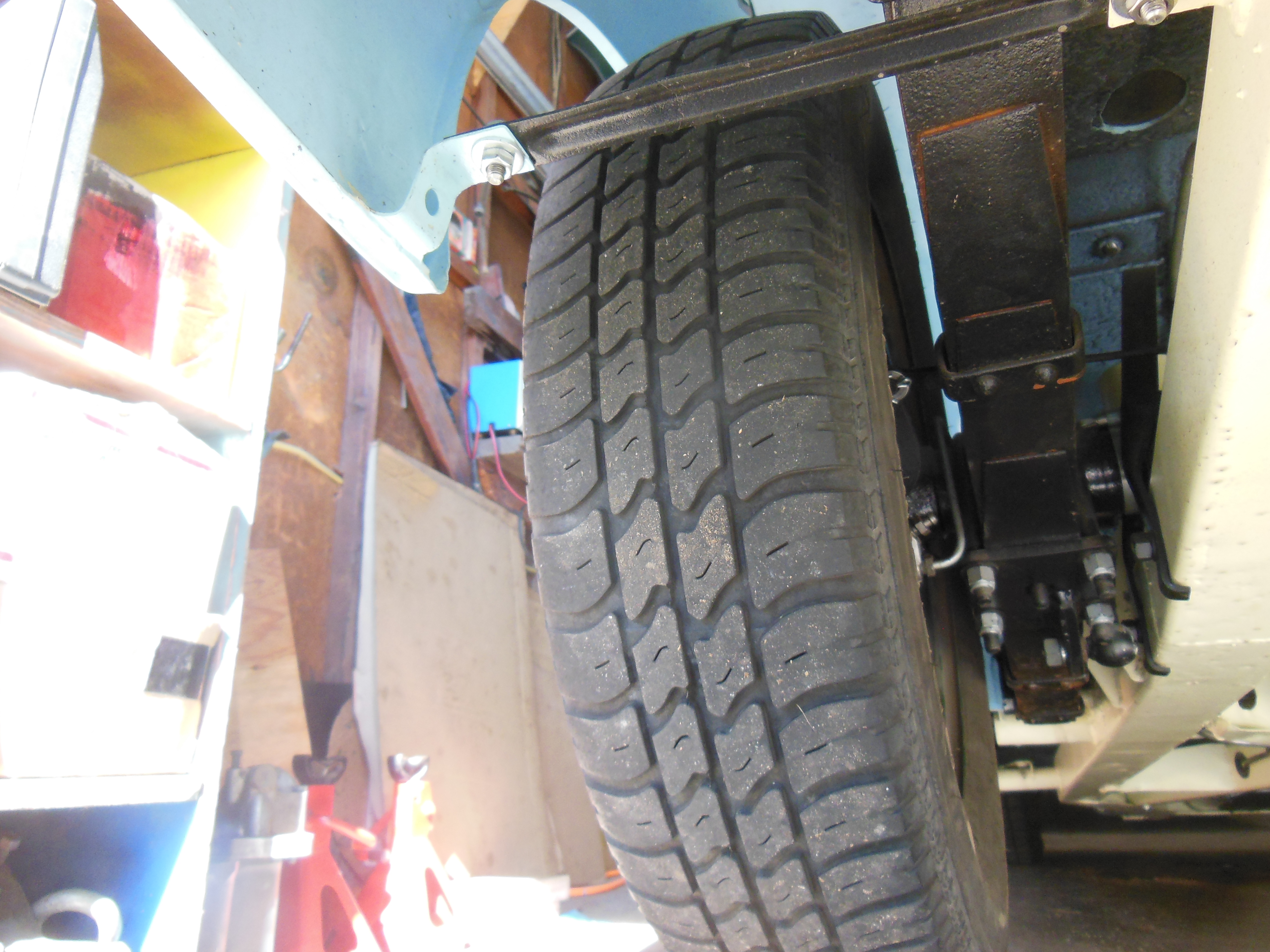

So, I went under the back of the car to look around for my problem with the moving to right when I accelerate or quickly de-accelerate. The differential is in the hole of springs and centered, but the driver side looks like spring shifts around latterly and the passenger does not. At least that is what I deduced from the rust pattern. This is a guess based on the rust that is starting to show between the leafs.
My experience with differential rebuilding limited, so I am guessing here. Anyways on this differential there does not appear to be one side that is dominate when the wheels turn. I guess like a positive traction rear end. Could there be some kind of limited slip deal because with the car up both wheels turn at the same time with the same strength, and if I try to hold one side from turning when the other side is turning I cannot hold it forward or reverse. I do not think my other car is like that; that car has a wheel that is dominate. Could that be the problem some kind of limited slip or positive traction that holds or forces something ??? Differential ???

That is not normal…could be something binding in the center pumpkin, or an aftermarket limited slip.
Studying the pics I see no issues that are obvious. The right side nuts are not threaded as far, but that should be due to the spacer. With the studs in the clamp there is no way it’s the diff moving. Same with the front…the eyes and front bolts look good.
I’m leaning towards the stiff pumpkin.

Thanks you guys. John comment that the differential should not act the way it does with both axles turning in unison. Is that something that could work free? Or better yet should I drive the car. In picture 0340 when I turn up the magnification on the picture, the driver side leaf spring looks like it moves latterly side to side. The leaf spring shows a weird rust pattern between the leafs like it is sliding.

Multiple leaf springs are held together only by the locating bolt that the penetrates the axle pad and the bolts that hold the axle to the springs. The leaves are supposed to move against each other when the spring flexes. As John said, there is nothing remarkable in your springs as pictured. For a better understanding of what an open diff does, google "diagram of how an open differential works" and take your pick of info.

Steve, even if the leaves slide a bit, the large leaf is what holds the axle in alignment. To prevent sliding, tighten the clamps with a big wrench, and/or hammer. You might check closely to ensure the large leaf is not broken and just being held by the other leaves.
