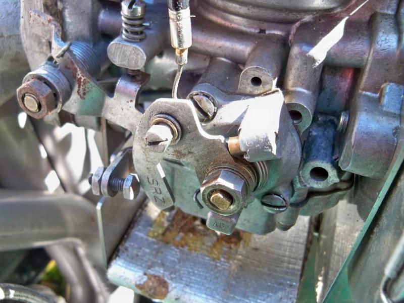

Be sure to use Full choke when when first engaging the starter...then begin to cut back after a couple seconds. ZS carb...FULL CHOKE 001.jpg
