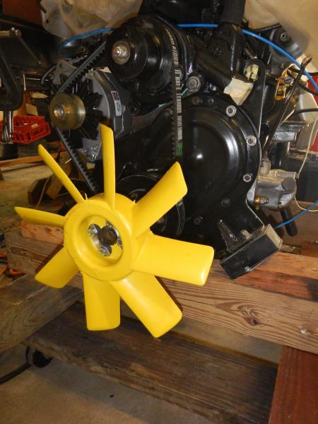

I have started my TR3A engine briefly on a stand with no problem but it was a secure stand.
David
