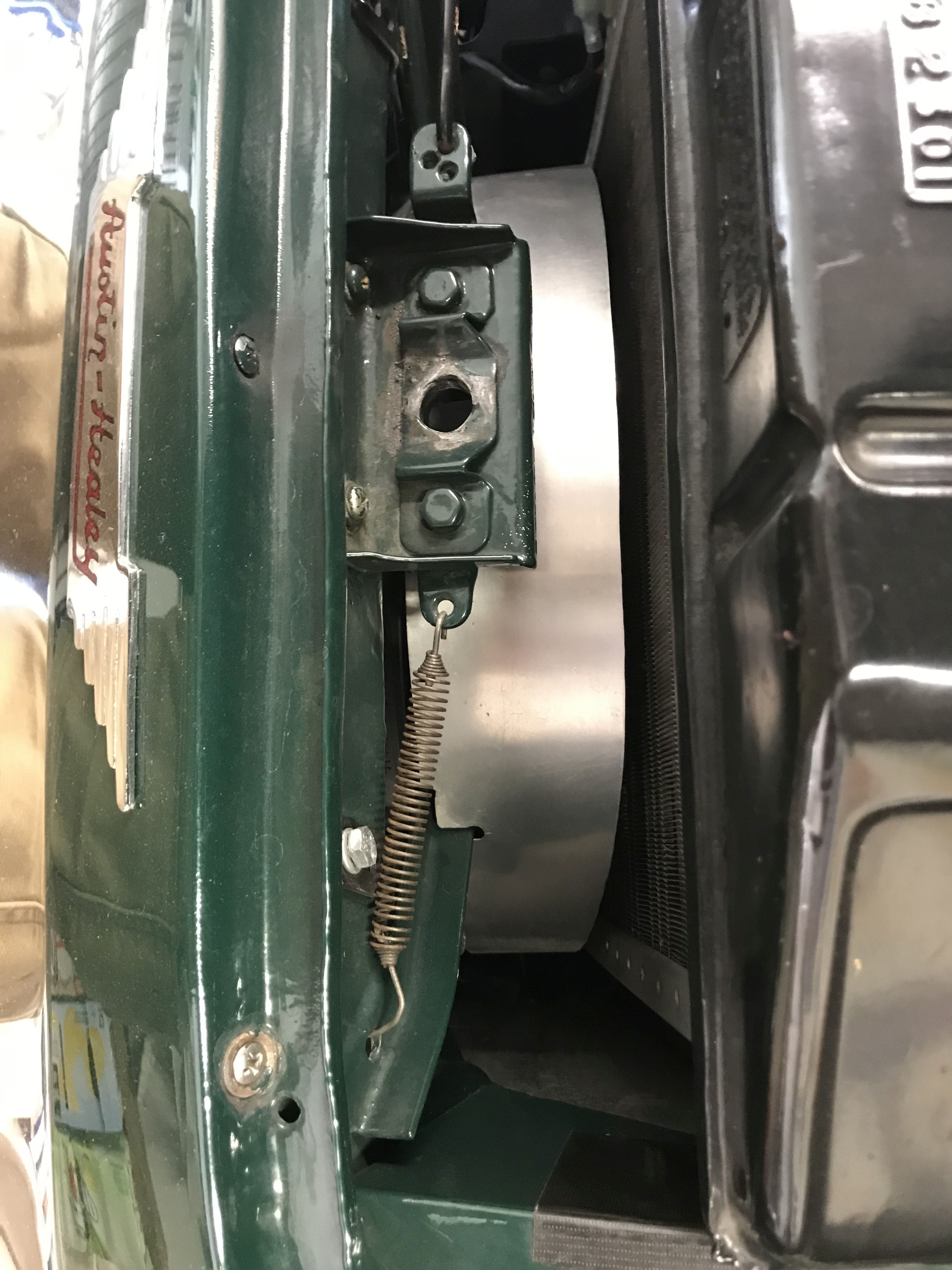

The thickness of the aluminum radiator core, condenser core and electric fan I thought I would have to modify the X-brace. I didn't want to do that. With the brass/copper core, they would all fit (barely), but I ended up putting the fan in front of the X-brace.
My radiator was increased in capacity and my condenser pretty much covers the radiator. I have a Texas Kooler mechanical fan and a pusher electric fan. The X brace was removed from my Jule Frame. The electric fan has a lot of back-blow and is almost as if it can not push the air through both Radiator and Condenser. I am leaning toward a puller electric fan. There is space to gain by moving the radiator forward with longer bottom bolts and similar modifications for the upper mounts.
John Turney
You've probably seen what Dougie did. I put a thin aluminum shroud between the electric fan and condenser so the air has a hard time escaping:
Patrick67BJ8
I saw Doughies photos he posted and I think it’s the best to get airflow through the radiato. I believe getting installation on the lower radiator mounts is the easiest with two longer bolts. I think he said he made a couple of brackets for the upper radiator mounts and leaned the radiator forward. Pulling air through a radiator is more efficient from all the articles on the subject I have read. Cape makes a puller fan for its aluminum radiator. Wizard might too? I believe I have located the source for Doughies fan/shroud setup.
