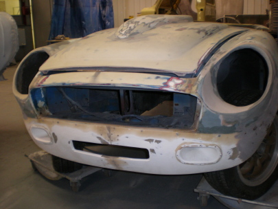

Took a few photos today. They're working the front edge of the bonnet, reshaping the edges of the grille opening for the egg-crate grille we're building, and we've drilled the rivets out of the brake cooling ducts in the front air dam. Next we'll fill the rivet holes so the ducts look like they're part of the air dam, add the chin spoiler to the front of the air dam, and finish the reshaping of the grille opening.
I stuck a paint stirring stick under the hood for the 2nd photo so you can see how it opens.
And the 3rd photo is a close up of one corner of the grille opening. If you look closely at the bottom corner, you'll see how we're rounding off the square edge and how whe're molding the ducts in the air dam.
