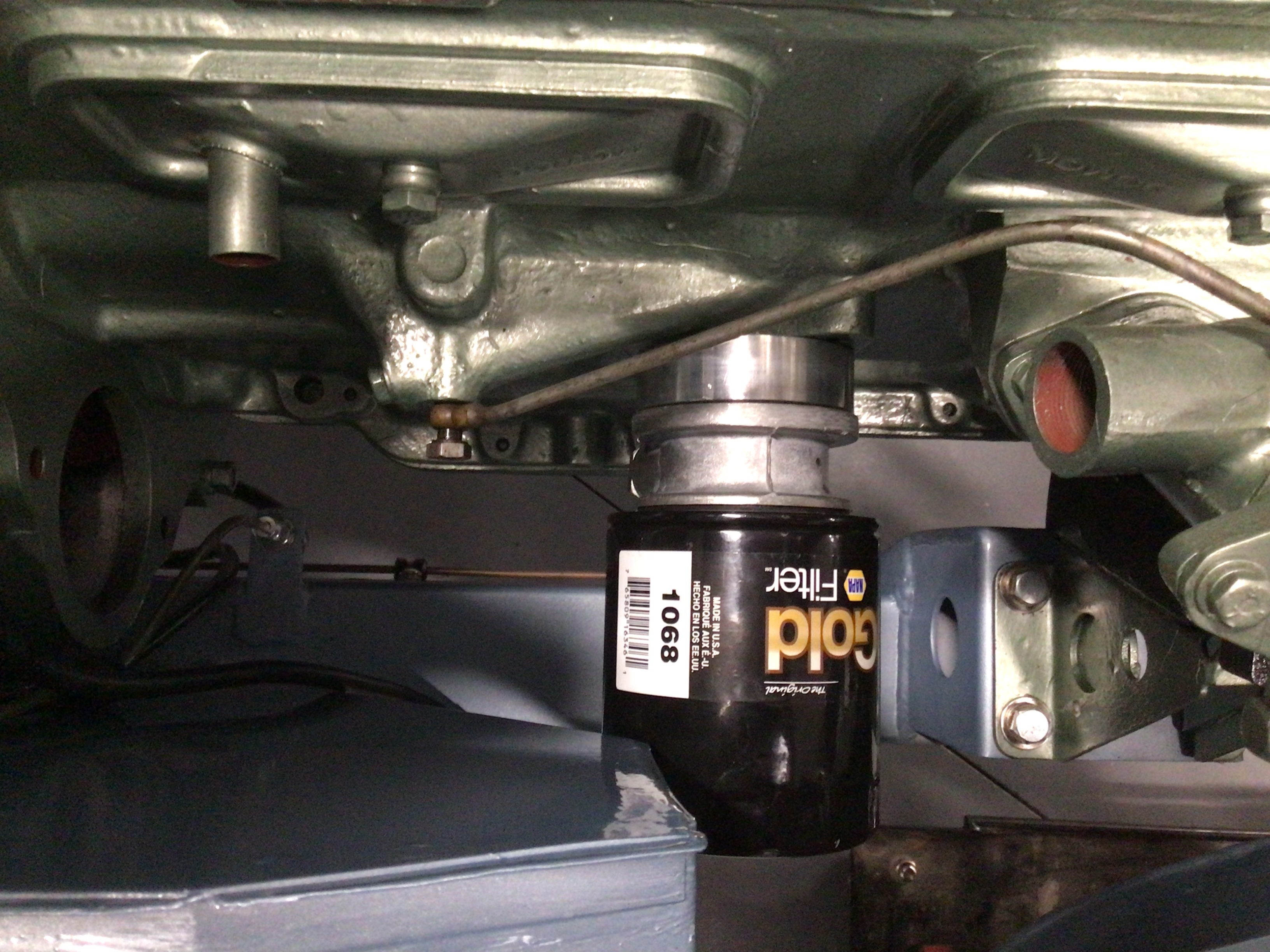

Healey Nut, what is the aluminum spacer I see between your Spin On adapter and the filter? Thanks.
ITs a diverter plate with threaded in and out connections on the bottom that will have hoses routed to the oil cooler .
thanks for the clarity. Without the hoses I went into brain fog.
