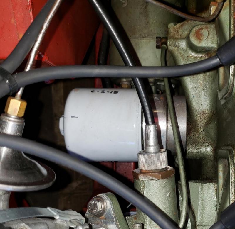

PS - here it is installed with my extra sandwich plate for the [semi-useless] oil temp gauge. Is this a good choice for the BJ8 clearance-wise?
I use to use the 2004 for clearance until someone on a forum pointed out the smaller filtering surface would have less ability than the 2009. As I change the filter every year (3000 to4000 miles) this is probably a moot point.
