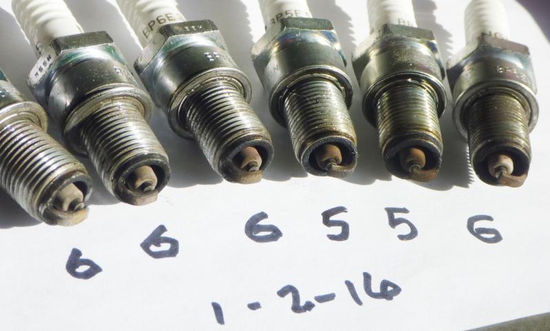

I've run the car now for 3 months with 4 @ BP6 and 2 @ BP5:

Th Sparks appear to be good, you probably find the better solution for your engine- what are your driving impressions?
I can follow your solution for my 3 front cylinder-but I am unsure, actually my engine go very well -(with 100 Optane fuel)
Looks a bit rich on the three sooty plugs. Go carefully through setting up carbs after having made sure timing is exactly right. Could be needle valves in float chambers or jet needles. Measure distance between top of jet and bridge.

My engine is a bit tired. Had oil fouling on 2 & 3 so that's why I went to the hotter 5 plug. In Calif we run 7-8 pct ethanol in the gas which seems to run leaner; my HD8 jets are .095" down. I've worked my way down from .081" but had to go that far to get rid of backfiring on downhill.
PS - my neighbor (BN7) runs his HD6s at .055" down.

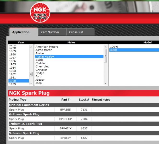

FWIW NGK recommend B5ES for the Healey and if you used those they be paler. If a plug is a bit cold for the application, it will look black or rich. Same happens if ignition is retarded a little.

I've got a seventies NGK spark plug applications book that I've kept because it covers a lot of older cars. It recommends a 5 grade. I doubt it will matter which you use and I only mentioned it because yours looked black.

I think a 5 would be better for a standard engine. I'm using a 6 in my high compression, 215bhp motor and the plug colour is excellent. When I got the car it had 7's installed but they are too cold and were always oiling up.
In the spirit of experimentation, I'll probably go ahead and install the 5s this winter then keep an eye on them as it warms up for the summer. I've owned the car for 15 years and never had a problem with 6s until last year.
I've been using BP6ES NGKs for darn near four (<4) decades, along with a variety of 2.6, 2.9 and 3.0 litre engines and states of tunes; 2 & 3 SU carb setups (1-3/4" for the dual and 1-1/2" for the triples) with stock and BJ8 cams, and triple 45 DCOEs with a BJ8 and since 1986, with an Iskenderian T3 cam. Compression ratios were always stock, or the slight bump due to a .020" to .030" bore increase.
At one point, must've been around the mid-80s, I did back to back "tests" with both BP5ES & BP7ES plugs. I was living alongside a rural 2-lane highway, so doing plug-cuts and coasting into my driveway was a breeze (and I dearly wish I had that luxury today). The 6s were definitely the right choice, and I've settled on them ever since.
