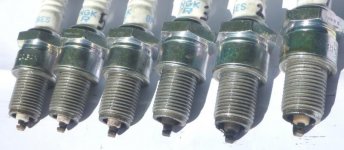

Recently my #3 plug fouled. I replaced all the plugs and this is what they look like after a couple hundred miles or less:
attachment.php
Left to right #6 to #1
I'm thinking it's an issue with the wires, which are copper with the Moss screw-on bakelite ends.
The plugs are BPR6ES
Cylinder #5 is 145psi; the others are 155 - 165.
Any comments or suggestions?

Hmmmmm ... even a Healey 'log' manifold does a better job of distributing mixture than that (four of the plugs look a little lean). My guess is weak spark to #2 and #3--maybe arcing in the distributor cap or cross-firing in the plug wires.
What do I win?
andrea
Very strange issue Steve-
clean the sparks (very well) and put the number 3 to 4 and 2 to 5 or better to 6-then cover aprox the same mileage -I am very interested on your next photo
My opinion -at this moment- are that your front carb must be controlled --but is better wait the results of this simple test
Problem is strange but not dramatic

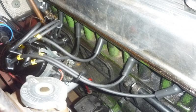

Forgot to mention they were factory-gapped to .033. Replaced cap, copper-core wires with metal ends, non-resistor BP6ES plugs gapped to .025":
attachment.php
Keoke
HI Steve
Try changing to Bosch WR7DP Plugs.
En get rid of screw on Bakelite ends-:highly_amused:
RAC68
Hi Steve,
I experienced a similar condition back in May of 2010 and posted on the Forum:
In preparation for taking an initial vacuum profile inpreparation for the installation of an oil catch can and PCV, I was surprisedto find a vibrating needle with low readings (7” to 14”of Hg) at a 900RPMidle. When preparing to adjust thevalves, in concert with recommendations, I found cylinders 2 & 3 with blackplugs and a nice brown on all others. Following the valve adjustment and after exchanging black plugs theirlight brown counterparts, I took the car for an hour’s aggressive ride and thenreexamined all plugs. Expecting to findcylinders 2 & 3 turned black, I was surprised to that all plugs were a nicebrown. However, the vacuum gauge stilldisplayed a low reading with a vibrating needle.
Now phase 2. Earlythis morning, after an aggressive run (it is common for me to shift between 4K& 5K RPMs), I ran a compression test. The reading were as follows:
Cylinder
1
2
3
4
5
6
Dry
170
162
165
171
171
172
Wet
210
200
210
183
183
183
Although I did intend to run a leak down test, I never did and the condition disappeared. However, I did adjust the carburetors and reset timing but don't think that really did much to eliminate the problem. Although I don't feel the wet compression was done reliably, the dry test seems to indicate the problematic cylinders did have lower compression ...but still within the 10%. This seems to reflect what you have experiences as well.
Since you seem to find no loss in performance, I would just clean and move the plugs to see if anything changes.
Good luck,
Ray(64BJ8P1)
RAC68
Steve,
Since our similar issues on the same cylinders seem to have no obvious cause, maybe there is something unique about cylinder 2 and 3 that is not related to the other cylinders. Although our engines were manufactured years apart, they are basically the same. So, what components, constructions, or passages are unique to the area between cylinder 2 and 3? Since, cylinder 2 and 3 are fed by the same carburetor, If a fuel supply issue, why is cylinder 1 not even slightly affected?
Ray(64BJ8P1)
steveg
steveg
Steve,
Ray(64BJ8P1)
Maybe we both have oil coming into the cylinders.
vette
Hi fellows, I just thought I would jump in here to add more fuel to the fire because my engine exhibits the same condition. I don't believe that it is oil in the cylinder as my plugs are more sooty than oily and the engine doesn't blow any blue smoke at all. I do believe that it is a carburation issue. Right now and all this summer my carbs have been running alittle lean as noted by the the piston lift method. But the front carb seems to be alittle richer than the rear. The leaness on the other 4 plugs is because the rear carb is deffinately lean and the No. 1 plug is leaner than 2 & 3 because it is further down the line or at the end of a longer runner than 2 & 3. Front carb being richer than the other but not by much. I believe if I get the carbs equalized and closer to the correct mixture then all cylinders will look much the same. Having said all that, since I put the carbs together after restoration, they are responding to my tuning efforts differently than they had in the past. Thats why they are alittle lean right now. When time permits I am still trying some things with them. Bye the way, My BJ7 has a BJ8 cam and HD8 Carbs.
The HD8 carbs are adjusted with the throttle plates completely closed and the idle speed it set with the slow run screw. the jet and mixture is set with a small screw which pushes a lever against a membrane damper which raises or lowers the jet. Previous to my restoration I had a membrane that was stiffened up and would not allow the jet to come up to it's at rest position. I didn't know that at the time and could not understand why I could not get the engine to idle much below about 900 rpms. since the restoration I decided to make the carburetors right, and that I would tune them with the slow run screws instead of the throttle plates. anyhow to make a story short, I have found that I can not get enough idle speed out of just the slow run screws alone, although I can have it running well at about 400 rpms that is not an ideal senario. So I am experimenting with cracking the throttle plates just a tesch and doing the slow speed adjustment with the slow run screws. In any case I believed that my experimenting with the adjustments of the carbs is what has been causing the difference in the spark plugs. Dave.
