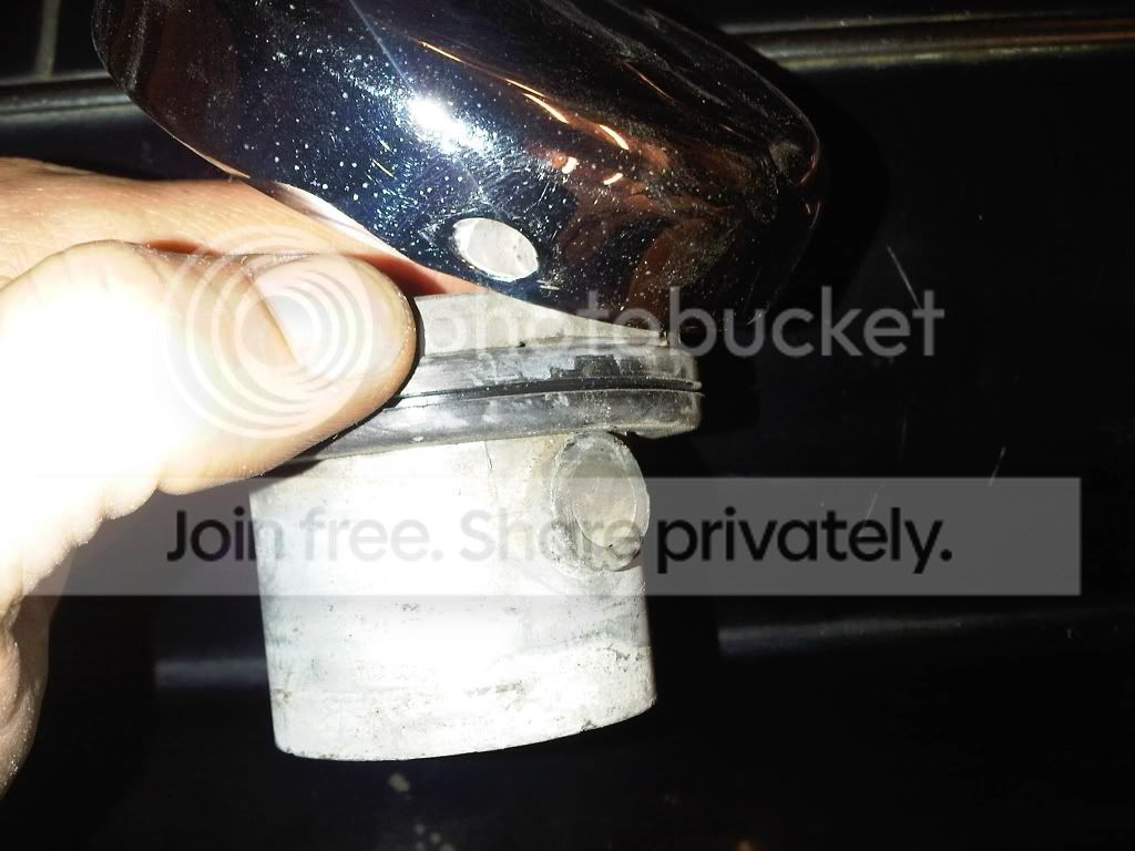

Hi guys - my metal filler has a circle on it that locates the rubber connector and it won't fit past the fitting in question. In addition to this it seems like they would be handy for fitting/removing trim.
Do you have a picture of your metal filler? I was looking through my spare parts and the 2 spare gas caps/fillers that I have don't have anything like that.
Did you get it installed?
Scott
Hi Scott - thanks for asking. Here is a (bad) picture;
Been working on the Bugeye and MGC, so nothing to report here.
Definitely, nothing like that on the 2 spares I have and I'm pretty sure that the one on my first TR4A didn't have one either. Odd...

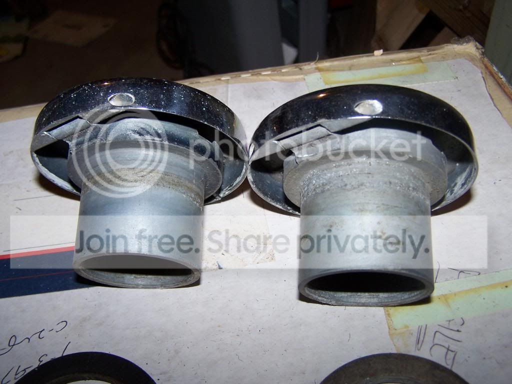

I have two like this - maybe TR6 items?
One on the left was on the car <span style="text-decoration: underline">without</span> the rubber gasket.
Tom,
Here's a picture of the 2 spare ones that I have.
