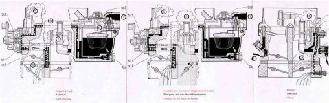

yep - I hear ya. Sure seems there's a blockage. But trying to find and clear it is proving a challenge. That 33 in your diagram looks very much like the 32 I have. Note the idling spray in the Idling diagram on the right. That's the flow I think I'm missing.

Tom, if your emulsion tube was plugged #65B in attached diagram was gummed up, I would also check the passage way between main jet#68A and #68 for blockage. Also check the choke disc for orientation. IIRC this can be installed a half turn off? thus not opening proper holes? Been a long time since I had anything to do with a Solex 32 PView attachment 24469aita

PS - I just tried blowing air from the port at #68a to #68. No air comes through. My eyes ain't what they used to be. Where on your chart would I see that passageway?

Far right pic shows idle circut fuel flow(indicated in black)from emulsion tube to idle jet below throttle plateView attachment 24471. emulsion tube should have a jet in it and it may have a small air jet along side of it. Google mbzponton.org pictures there may be easier to decipher.
Thanks. I actually got many tech documents from MBZponton. I agree that the right-most picture shows the connection from the emulsion tube to the idle mixture jet. But didn't you say something about "check the passage way between main jet#68A and #68 for blockage."
Far as I can tell, 68a leads to the fuel bowl, and 68 leads to the fuel bowl. Both of those passages are clear - but not directly connected. Thus I can't find the passage between 68A and 68 you mention.

I studied it a bit more, and would think it should run on the start circuit as it looks to me that is a curcuit all it's own.Fiqure 1 on the left side shows ST3 top right which is called starter air valve which looks like an emulsifier for the cold start circuit, see arrow just left of the number 6 behind float bowl which then shows fuel blended with air going to starter valve marked st 1 Hopes this makes some sorta sensePAITA33 (Large).jpg

Say, any idea how that "starter air valve" St3 works? I replaced the gasket when I rebuilt the carb. I can hear the valve pop open/closed when I push against the plate that shows on the underside of the carb top.
