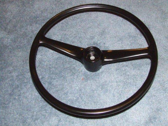

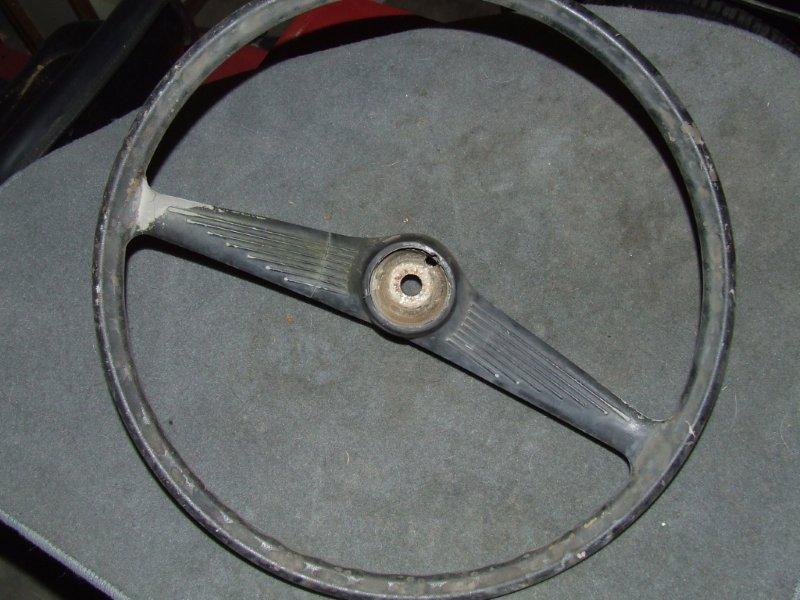

I got an old wheel from mightymidget a while back and restored it with epoxy... Looks about the same as the NOS one for about 950 pounds less.. :thumbsup:
Before and after:

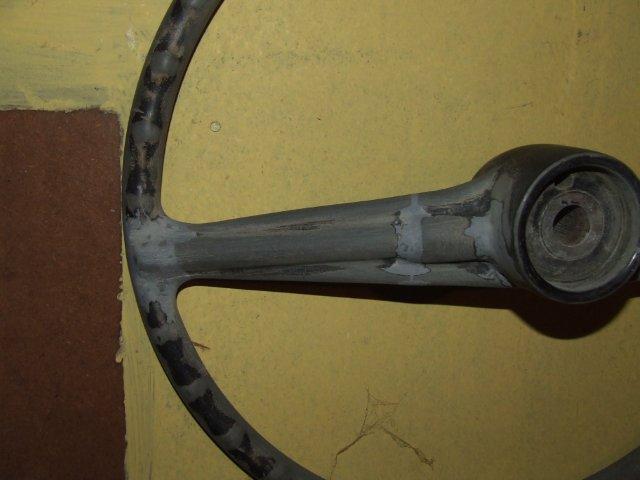

Some pictures of filled in areas during the work on the spokes. I cant find any pictures of the work n the rim, but there were many tiny hairline cracks that kad to be cut and filled.

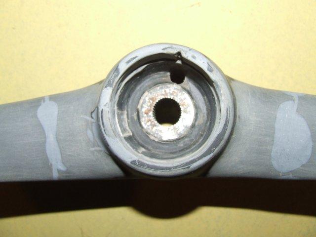

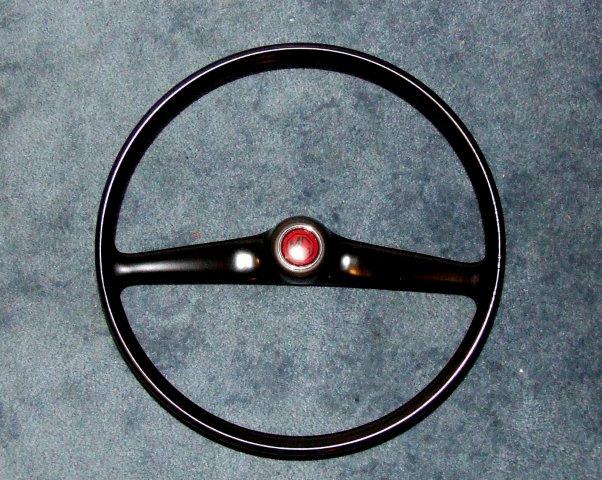

A couple more pictures showing the back of the spokes. this area and the left hand spoke to rim junctin had the most material removed and filled. Caused by cracks and water causing the inner steel to rust and swell.
There is also a picture of the finished wheel with center push. I took that apart and stripped/repainted it too. Not the original red/gold lettering. I like the Red/black better as it matches the colors of the car.
