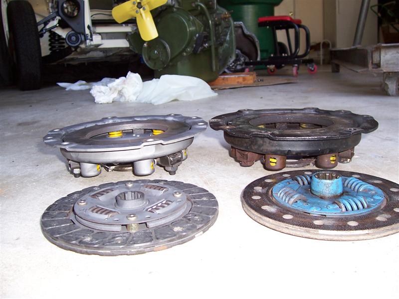

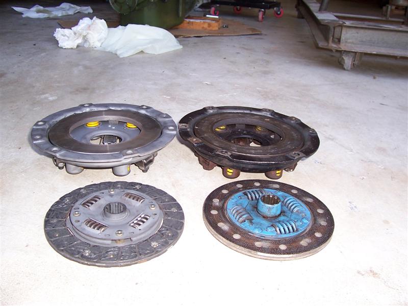

It is 1/4 inch thiner than the orginal. Also not how the center part of the disk is shorter than the orginal and how the center is thicker.
With a thiner unit how can it work? It binds on something, have not figured that out yet?
What the heck, over.

Pressure plate looks the same - clutch disc looks different.
Let's call them Monday & see what they say - unfortunately, they don't have any tech folks...maybe now we know the price difference between them & Moss!
Pressure plate is 1/4 inch thiner. Does not show up well in the pic, sorry.

At least you figured this out early. I installed mine and it lasted for two months about three thousand miles. The release bearing was shot. The carbon ring in it disintegrated. I wound up putting the original pressure plate back in and another release bearing. When we got the replacement unit out we measured it and the release bearing surface on the new presure plate was about a qurater inch further from the flywheel than the original. Thus haveing the release bearing jammed against the presure plate full time.

"""""""""""It is 1/4 inch thiner than the orginal. Also not how the center part of the disk is shorter than the orginal and how the center is thicker.
Pressure plate is 1/4 inch thiner. Does not show up well in the pic, sorry. """"""""""""""""""
You may ..(or may not) have the correct parts....orbe ding it wrong.
Jack....If the clutch cover assembly is thinner or thicker by 1/4 inch that SHOULD be no problem. OR...if the shoe is thinner or thicker that also should be no problem. The shoe is the part inside the cover that is solid and contacts the clutch disc.
The center part of the disc is called the hub. The hub, in your case is riveted to the disc center and the lining is riveted to the center. The thickness of the splined area in the disc hub CAN be shorter or longer. It just cant be so long that it bumps into the flywheel.
1. Lay the disc on the p.p. with the disc rite side up.
There is a front and a back on the disc!!!
The outside diameter of the disc and the o.d. of the shoe should be the same...+ - .050" or so. The inside diameter of the disc might be smaller than the I.D. of the shoe. There should be clearance for the hub inside the i.d. of the shoe. Then ...put the disc up to the flywheel. The hub assembly shoud clear the recess in the flywheel and the flywheel bolts. Determining then that the parts fit, put the disc and pp on the wheel and tighten the 6 screws. The pp should pull down evenly and the throw out bearing pad should move inward(forward) as you tighten the pp. Meaure the height...from the to bearing face to some dimension forward and compare it with the original. It should be in the approxamate location of the unit you took off....or maybe a little rearward as much as 1/4". Then using a NEW t.o. bearing screw trhe trans to the motor and the throwout fork should be back of a perpendicular line thru the front to rear of the motor a bit. Rotate the motor BY HAND and make sure you have clearance in the bellhousing to the pp.

It has gone back to Tony for return at this point. If it is supose to be for a 948 I should be able to bolt it in and use it. Otherwise it is not made correctly.
Oh gesh, forgot the pics Tony, can you print em from what I sent email on regular paper?
