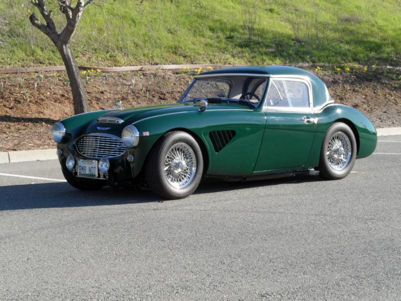

Get the ones with the flanges I think moss sells them IMAG0092.jpg did mine some 20 yrs ago they might have been from kilmartin.There was an article in the chatter mag some yrs ago i'll see if I can find it,also there are quality issues with the vents when I was looking their not all the same

There was a member in our club with a V8 in his 3000 all he did was add a set of early Jaguar vents to his fenders. He said that took care of his heating problem and esthetically they looked nice too.

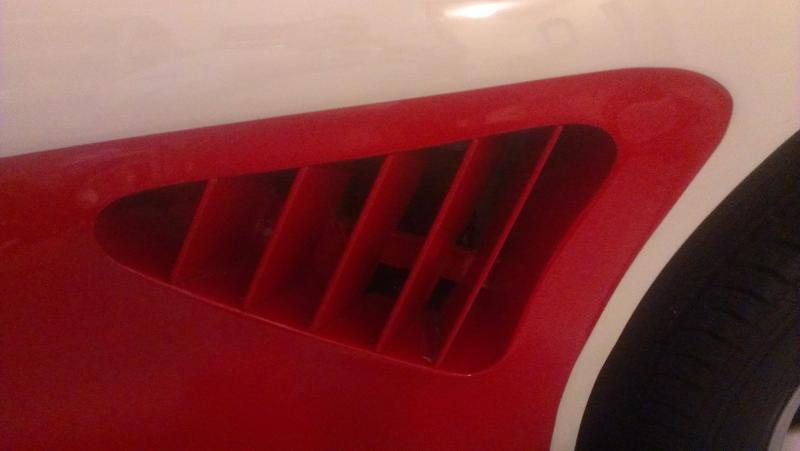

I got the aluminum ones from AH Spares. They are steeped in on the inside which will clear the footwell.
I then made a wood buck template, practiced on a piece of sheetmetal.
Determined the location on the fender lining up the buck but also allowed a 1/2" overhang, marked it out and cut the fender.
Placed the buck on the inside of the fender, clamped with wood blocks on the outside and took a selection of hammers and hammered the metal over to form a flange. Trimmed it up, placed vent in place overiding the flange, drilled holes and eventually poprivited it in to place just like the factory had done.

could you provide a close up picture of the vent in place! thanks if you can!
