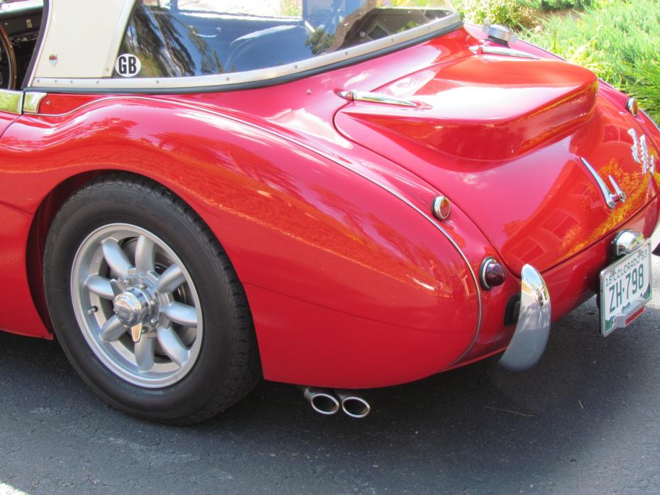

I built my side exhaust.... used the regular Moss replacement muffler.. got some exhaust pipe with 45 deg angles, welded up some connectors and made a new hanger. They exited right in front of the left rear tire just like the Works cars. It worked great but as already stated on this thread it was pretty loud (even with a stock muffler). It was fun for about 20 minutes per drive.... then, not so much.
I wanted to keep the Works "look" but reduce the volume so I moved them behind the wheel. The difference is significant... still a nice sound, but with the extra pipe length and with them behind the rear wheel it's much quieter at speed.... love it now. FWIW

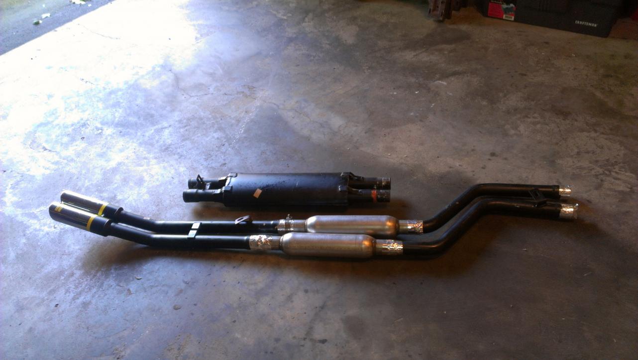

if you want i have a monza exhaust with added walker glasspacks nev130.jpger used it you would130.jpg130.jpg need to do alittle welding

Steve -
That's a nice solution, your cars waaay to nice not to drive often. I fabricated my race side exit exhaust system using Spintech's ultra low provide all steel race muffler and custom oval tubing and Y-connector. This allowed me to design the whole unit to run parallel with the lower edge of the chassis rail and with the car lowered an additional 1.5", I have no ground clearance to spare. Starting with 2.25" round tubing from the headers, it mandrel bends to the Y-connector which transitions to 4" oval in the muffler, then exits with twin 4" ovals in front of the rear wheel. Ear plugs are a must for anything other then a quick spin around the block. The neighbors frown.... urrrrr moms do, kids and dads are all thumbs up. :cool:

I've been planning to fit a side exhaust to my BJ8 too, but want to fit as large a muffler as will fit. I just want to get rid of the pipes rear of the axle. The current pipes are fouling the telescopic shock kit i have waiting to fit.
I thought this set from AH Spares looked pretty good - but its hard to tell how long those mufflers are?
