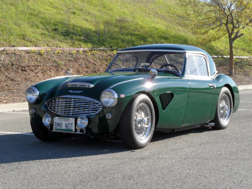

Does anyone have opinions on the angle the exit pipes clear the sill at? I see Andrea's looks like it comes out at right angles to the sill, others aim towards the rear at various degrees... Does it make much of a difference to the flow of exhaust fumes - thinking about deposits on the paint and wheels etc. I had a pipe exiting just behind the wheel for a time, and it fouled the white paint rear of the pipe.
Mine's at at about 60-deg, rather than 90-deg. I think it has more to do with how long the muffler is and where it's mounted. I have a stock (for a 100-6/early 3000) muffler. Mine also comes out from the sill about 3 - 4 cm and the ends are cut straight instead of at an angle. I've noticed no fouling.
