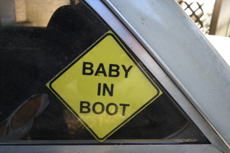

Not side curtains, rather the quarter-lights of an MGB factory hardtop. Went to a local sign shop with rough dimensions (length & width) and a measured thickness with micrometer. The thickness is about the most critical in my case, suspect same for the side curtains. Material had to be ordered as the thickness was odd. Plexiglass. Lexan seemed overkill. Used the old window pane as a pattern. As long as the plexi is washed/cleaned with soft cloth, no scratches so far, it's been good since 2006 in Florida sunshine.
Same sign shop made me the caution sign in one side quarter-light:

Ah, that’s why I didn’t recognize...
