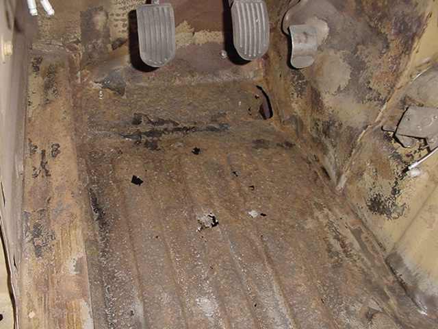

OK, I have some rust in the floor of drivers side in the B (beast) and need to know if I should replace or patch.
I am going to try an attachment. There are a few very small holes and one that is larger. I did no find these untill I was wire brushing to clean the surface rust out.
The rest of the car is nearly rust free.

From that photo, were it me, I'd at least replace the front half - in front of the seat - if the area under & behind the seat is solid. That way you could buy the less expensive floor (Moss #458-950) that doesn't have the captured nuts for the seats & get away for less than $100 in parts.
Speaking of rust.... First off, I agree, yet again, with Tony. Replacing the front half is a good idea.
I have been using a product called 'Rust Doctor' in areas of surface rust with some success.
You might check it out at Rust Doctor
If the rusted area is corroded through, I replace the panel. If it is a surface rust areas, I paint this schtuff on after I have brushed the areas relatively clean of surface oxide. This is a compound that turns the surface rust from iron oxide to magnitite, an inert oxide and seals it with a laxtex based compound. I then primer and paint as usual. It has worked well for me. /ubbthreads/images/graemlins/grin.gif
Just for those that may miss the attachment... It's clearly swiss cheese by now.
I agree with Tony on this one, but I might also give a cautionary glance at the sills to see if they too are suddenly appearing to be holy also.

I replaced the pans with the Pressed Steel ones from Vickie Brit. Over all they were a good deal. Only "complaint" is ther e are no seat mounting nuts attached. I used "NutZerts" for the task:

Yes I am looking at replaceing the front portion of pan.
