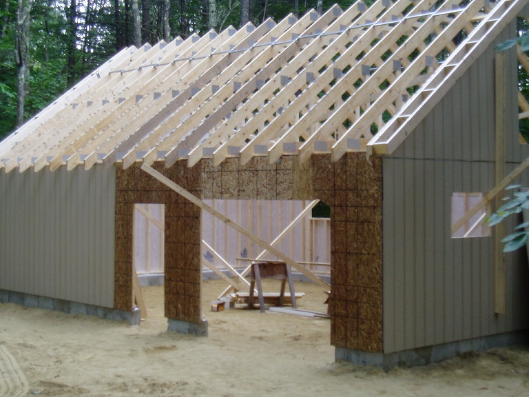

I decided to post a new thread succeeding my Shop Size query, which produced lots of valuable replies. Here it is so far, 24 x 36, the max budget would allow. (Actually roof sheathing is done now too).
attachment.php
I have 200 amp service delivered underground and plan to run wiring for a generous number of 110 outlets through conduit on the outside of sheetrock. There will be 3 220 outlets wired the same way plus hardwire to compressor.
The part I'm wondering about is the overhead lighting. I'll be relying pretty much on electric lighting as there is very little sunlight available. Budget will not allow LED so probably will need to stick with old school florescent unless someone can suggest a better option. Also interested in thoughts on size and number of lights. Your insights again will be appreciated.

Thanks for the reply. My first thought was for 2 continuous rows of 2 bulb 8' units. Probably not enough? I guess the budget could handle 2 more rows. The distance between the rows would be a bit under 6 feet, less if the edge rows were set back from the walls. Enough?

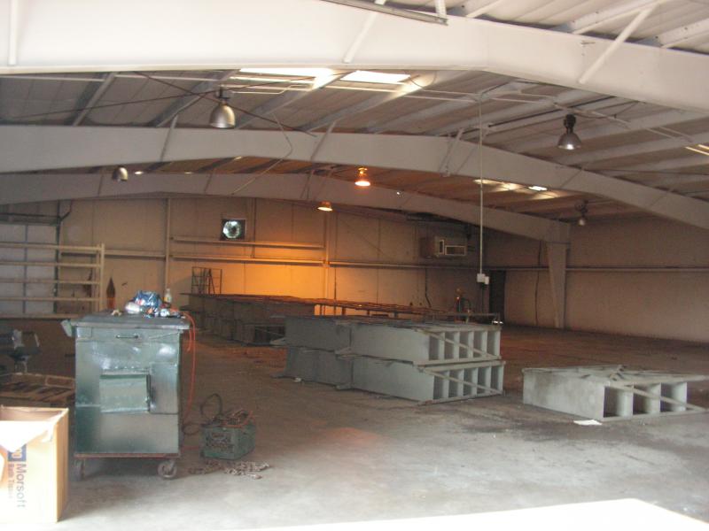

have you considered a few skylights they provide free light my 7500 sq ft commercial building had 8 along with 16 halogen fixtures and many days didn't have to use them at all.

I like the idea. Just were not available in what I could afford back then. I like the ones they have that are mirrored for kitchens and hallways now too.
I had skylight panels installed in my shop and the light they let in is amazing. Took a while to get used to the fact that the lights weren't on when leaving the shop. They are a worthwhile investment, keeping the electric light bill at a minimum. PJ
