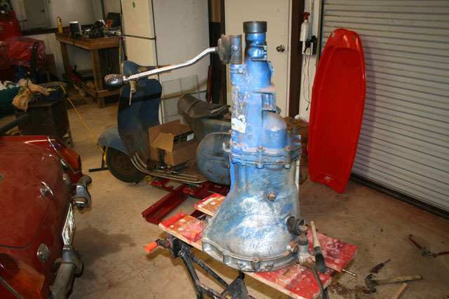

Note on Ed's transmission above how long that shifter is.
When in the Midget or Sprite the thing sticks up above the dash.
Not at all comfortable for driving.
The one I'm using now is cut down to about 6 inches and is very comfortable to use. Something to think about.

Shift lever shortening definitely needs to be done. My 4-speed shift lever isn't so bad, but the 5-speed one pictured looks like an ape-hanger....I might just use my 4-speed one.
Is that a shift lever in the picture? I thought it was a chinning bar!
The Rivergate manual suggests cutting the Datsun lever off fairly close to the transmission and then welding the upper portion of the Spridget lever along side (I don't have the manual in front of me, so this is memory and could be wrong). So - if someone wants to keep that chinning bar portion and sell me the bottom couple of inches....
