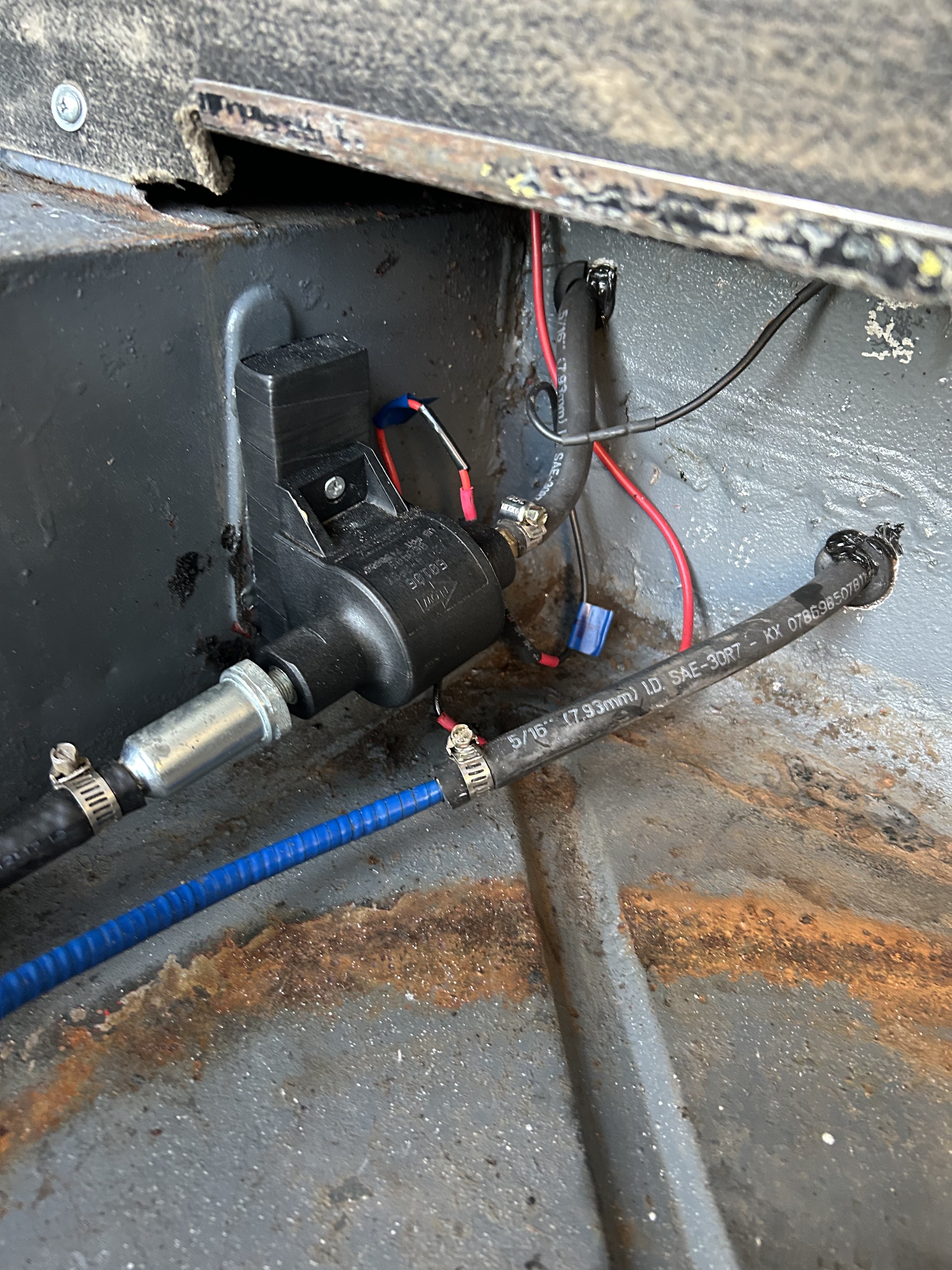

Opinions on what I should try? Should I check one of the wires shown in the pics (fuel pump)? Should I check the cable coming from the gauge?? Stablizer - not sure where that is at - I'm not sure what to check but hoping I don't have to pull the tank out and pay for that. What safety precautions should I take. Thanks all
Wires at the fuel pump should have nothing to do with this. First check the wires between the voltage stabilizer (VS) and the gauge. The VS is located in the passenger footwell. On the very front upper right corner. PITA to get to but there it is . The wire then goes to the gauge and could be loose. Could also be a bad ground wire at the sending unit which is on the passenger side accessed from the trunk.

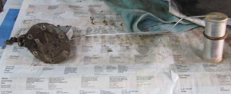

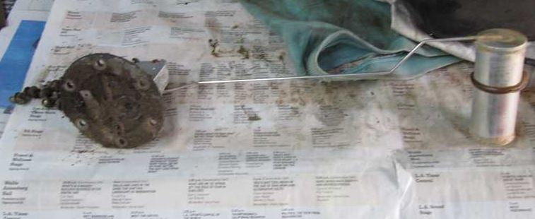

here are some resistance readings you could use to verify if your fuel gauge sending unit is bad.
1/4 tank = 200 ohms
1/2 tank = 82 ohms
Full tank = 70 ohms
These are readings I used while designing my solid-state voltage stabilizer. They are approximate readings.

With the ignition key off. Remove the panel in the boot covering the gas tank if you haven’t already done that. The fuel gauge sending unit is on the top of the tank on the right side.
You have to remove the sending unit to test it. When I replaced my sending unit a few years ago I was able to do it without completely removing the fuel tank by removing all of the bolts holding it except the very bottom ones which I just loosened. At that point you can pull the top of the fuel tank out enough to remove the screws holding the sending unit in the tank and then remove the sending unit.
Once you have the sending unit out use a multimeter set on ohms to measure the resistance between the 2 terminals on the sending unit as you slowly move the float up and down. You’ll probably need an assistant to do this. What you are looking for is a smooth change in resistance as you move the float up and down. If the multimeter goes to “0” at any point you have a bad sending unit and the good news is that you already have it out of the car. The sending unit was a bit pricey as I remember but you need it.
