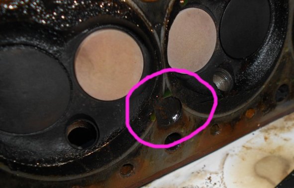

Recommend Payen black gasket....avoid the copper steel sandwich gasket. Might want to check head with a steel straight edge to make sure its flat and might want to get it worked while its off. Worked will cost so its up to you.
Kurt.
You may want to check that brass plug a little closer since the gasket failed right where its at.
Kurt.
Thanks for the tip on the gasket. The pictures do make it look like the brass plug is closer to being recessed than it actually is. I went back out and looked again...it's definitely well clear of the cylinder walls.
When you put the gasket back on, do you use sealant like Permatex, or will the torque from the bolts keep everything in place? Same question for the intake and exhaust gaskets.
By recessed we mean it is lower than the flat surface of the head. When you look at the cleaned head it should look like an integral part of the head except brass colored. Most fit the gaskets dry. For some stupid reason I still like to use a little copper sealant on the head gasket.
Kurt.
That brass plug looks questionable at best! Have the head checked for straight and if it's not, get it milled to take care of both issues.
Rut
Looking again, it has recessed about 1mm. On my particular head, though, it is located nowhere near the actual cylinder, unlike the earlier thread. So, I'm presuming this is a machine shop job to do?
I suggest you go ahead and have the head rebuilt by a machine shop. Give then instructions on fitting a threaded plug there. Then they can skim the head to be sure it is 100% flat. They can also install/grind some exhaust valve seat and new guides. Do it once and do it right.

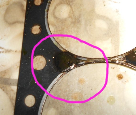

I think you are making assumptions about the plug that are not true. You say the center plug is recessed 1mm. That means the plug needs to be replaced or you will blow the new cylinder head. As for placement, it is exactly where they all are. Same 1275 head design, same plug, same recession problem, same point of failure. It's dead, Jim. Get it fixed now or you will be doing this job again within a month. That is how I leaned about this issue. Make sure the shop uses a solid plug or find one on your own. Home Depot and Lowes have the hollow plug so go to an Ace or an independent hardware store and get the good solid one.

Since you have new valve hardware might as well disassemble the head and maybe save a few labor bucks. While you are hunkered down under that low, low hood, how is your water pump? (Am I a trouble maker?)
Here's a nasty ol' blanking plug and it's effect on the gasket:
Hap has described exactly how he does the plug so it will never give trouble again! In the archives though I have no idea how to access it. The factory way was the wrong way! {Probably the cheapest though!}
Kurt.
The text below is from Hap's post:
"I've posted about doing this repair before, I even done it for other shops. You remove the recessed plug, which I do by drilling and tapping 1/4"-20 hole in it, and then use my slide hammer and a adapter I made to do this, and pull it out. It comes out easy enough using this method. Once the plug is removed, I use a brass male square peg 3/8" pipe plug, I have to drill the hole slightly bigger to do this, you would use the suggested drill size in a NPT drill tap chart, there are many on the internet to refer to. Then I would seal the NPT plug with JB Weld, thread it in, let the epoxy set up, then use a cut off wheel to cut the plug as close to the head deck as you can get without touching the head deck, then have the head resurfaced to the point the plug cleans up. You end up with a solution better than what the factory did, because the threaded plug will never recess. "
I think I know what caused all this trouble: I changed the thermostat because the car wasn't getting more than 1/4" off the "Cold" mark. When I replaced the thermostat, I didn't put sufficient coolant in the car (it only filled to the thermostat, when it opened there wasn't enough coolant in the system. The car began to overheat and pegged the temperature gauge briefly before, but I got it home before it could boil over. I didn't think I did any damage, but obviously this must have been the incident that caused the plug to recess and the head gasket to give way. The irony is the thermostat change had no effect whatsoever, and now I have a head gasket issue to address. I would have been better off leaving it alone. Live and learn.
