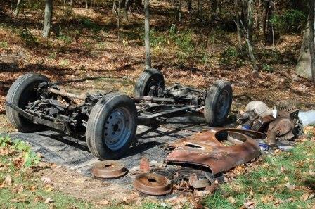

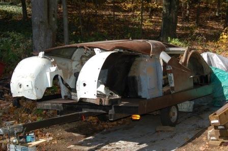

Four years ago I bought TS42031L. The car was produced on January 7, 1959; according to Frank Conklin. Thanks for that info Frank. I drug home two trailer loads of parts that are supposed to be a TR 3. I paid $1200 and along with the car I got about $800 worth of new parts that the previous owner had purchased. He bought the car in this disassembled state hoping to restore it. Twenty five years later he gave up. He kept it in his wood shop so it was always dry and always covered in sawdust. However, the other owners must have left it out in the rain, always. The other important numbers are: Engine TS 42667E, EB 41976, Mulliner 1017062
About the only thing the PO did was sand blast the frame, paint it and attempt some repairs on some of the fenders. See pictures.

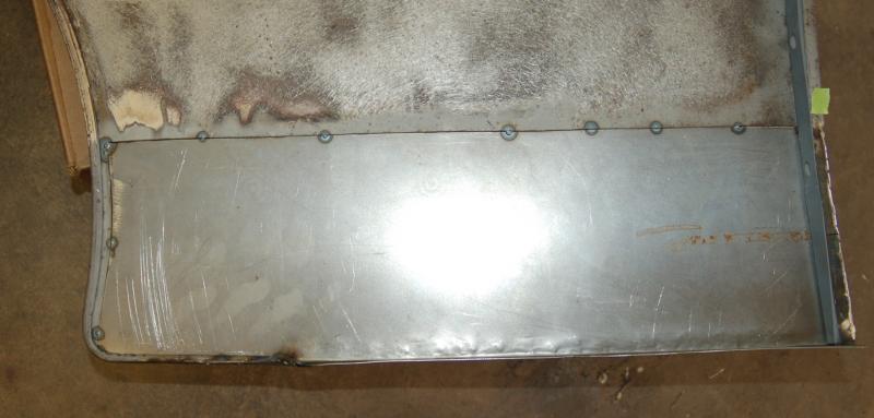

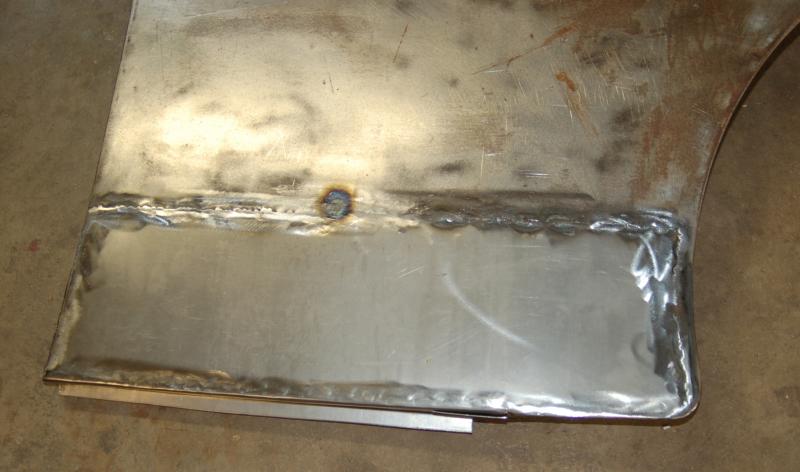

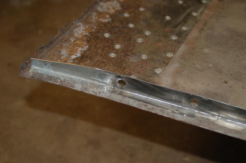

Here's a brief update. I have the lower patch tacked in place and I think it fits very well.

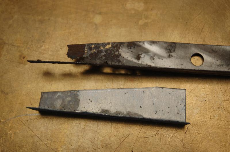

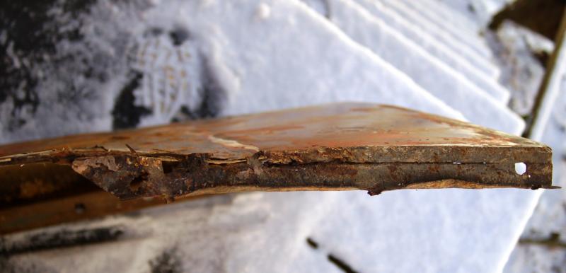

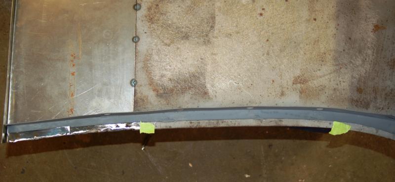

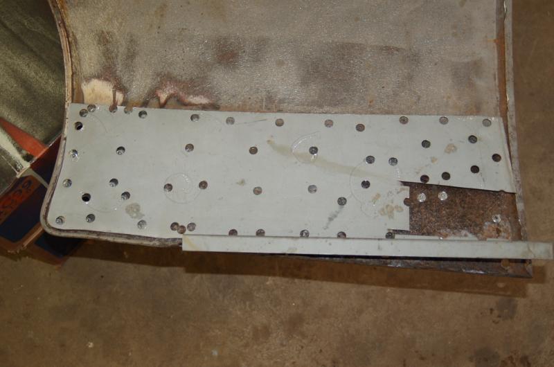

Before removing the rear mounting flange I drilled two small holes through the lip of the fender (the green tape shows the location of the hoes) deep enough to dimple the flange. That way I can be assured the flange goes back to its correct location. Just align the dots and all is good. I ground off the welds and knocked out the flange. The flange is now temporarily in place. It will come back out before I primer the backside of the fender. The next step is to recreate the part that actually attaches the fender to the car on the lower edge. I'll be using Johns photos and descriptions and also this rusted piece of crud on the left fender as guides.
I assume the nice round hole towards the rear of the flange is for the mice to get in there.

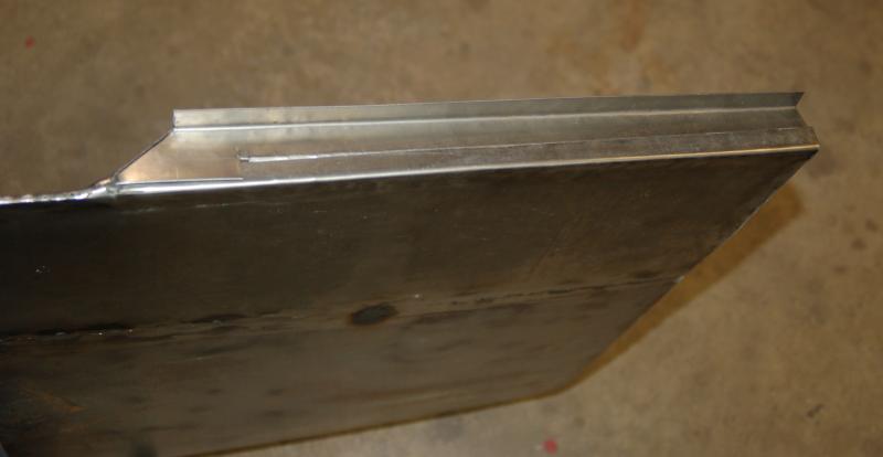

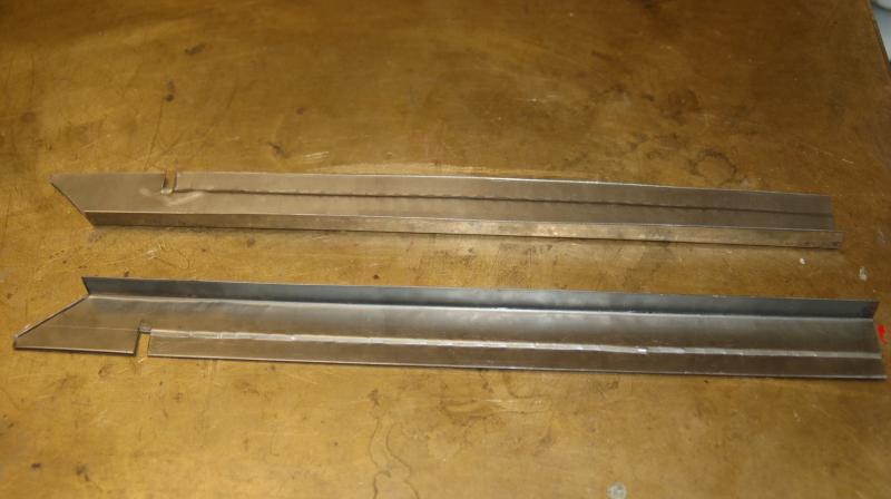

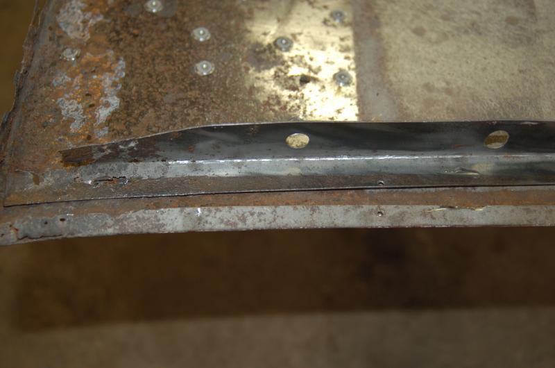

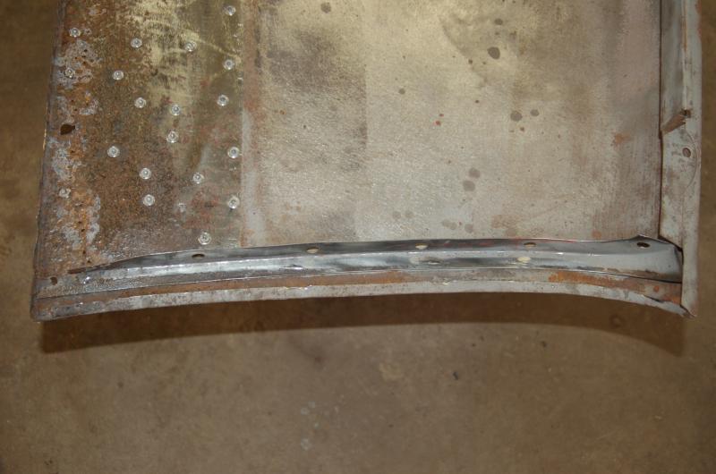

Here’s an update on the fender repairs. I made a pair of the lower flanges and I think they fit pretty well.
At least the one for the left fender does. The right fender is still a rusted mess but I figured while I was making one flange I might just as well make the other.
The dark blue spot in my lower patch is where I tried some heat shrinking. I had a high spot and that pulled it in very nicely.
Still have a little welding and grinding to do on the patch and I need to flatten out those hammer marks and then I'll weld in the flange.

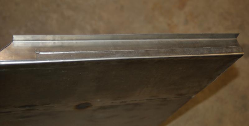

Now I have a question about the wire in the rolled edge. What have any of you guys done to stop rust in that area?

Very nice. It's looking like a new wing.
I'm afraid I didn't do much for the wire. I simply doused it in primer afterward...but then my car will likely never see rain again.
Thanks John.
It is likely that this TR will also never see rain. But living here in the northeast we get intensive humidity on certain days when the weather warms up and the garage floor and cars are ice cold. This makes the floors and the cars sweat. There's nothing I can do about that. I do not have a heated garage. Only the shop is heated and the finished cars can't stay there. So rust preventative measures are critical.
Maybe someone else will chime in on that issue.
Bill
Open the seam up a tech, wire wheel brush as good as possible then pour in epoxy primer.
Dave, you know what that seam is like. You're the guy that made a wire edge patch for the front section and now you want me to open it up? Come on over when you get some free time.:)
Now don't pervert the issue. the one I made doesn't need opening up because it is new metal and has no rust. Probably see you tomorrow.
What do you plan to do to the inside of the wing before painting? Sandblasting? You could do a coat of POR15 before primer.
