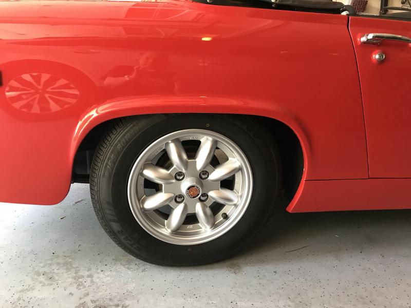

The sorting out continues...I was watching a vid on tire sizes on Midget Mania and noticed that none of the tire sizes shown are covered by the lip of the rear fender the way my 155X80R13's are as shown in the attached pix. Does this look OK for the tire size or are my springs really sagging that much. Thanks.

The wheel arch does cover the top of the tire. Perhaps showing a picture of the entire side of the car or the car from the rear may be helpful. A lot of Spridgets suffer from "Bachelor Lean" where the left side spring wears faster than the right.
Got real busy for a while, here is a full side pix. When I checked the leaf springs I saw that the bushings are shot. I ordered new springs and the super pro poly bushings.

Based upon the photographs provided, I personally see nothing wrong or unusual with the ride height of that car.
Nor do I. Hard urethane shackle bushings will tighten up handling though. I like Prothane.

Gentlemen, thank you for your observations. I'm waiting on some parts and will replace the bushings with poly. Since I will have it apart, I'm thinking I should also replace the 50 year old springs. Any thoughts?
Don't replace them. You will find that replacement springs are not the quality of the originals and will be WAY to high in the back. If you do anything with them, rebuild them. I think I have posted on that a few times and you should be able to find that discussion in the archives. I've rebuilt several sets for Spridget's and MGB's.

Well, since the ride height is good and the springs look fine, it appears that the shackle bushings are the only part in need of replacement, can I replace these and the spring pads with poly while the spring is still attached to the front mount or do I need to remove the whole spring to do the job? And is replacing these parts with poly parts the way to go. I use the car for spirited back road drives.

Left the springs and replaced the shackle bushings and spring pads with superpro poly, definite improvement back end doesn't feel sloppy. Have new shocks and sway bar up front. I want to tighten the rest, what's the best way to proceed?
Next you start spending money!:grin: Panhard bar in the back and have you checked the play on your bottom front A frames? Inside bushings and wear in the trunnion commonly needs addressing.
