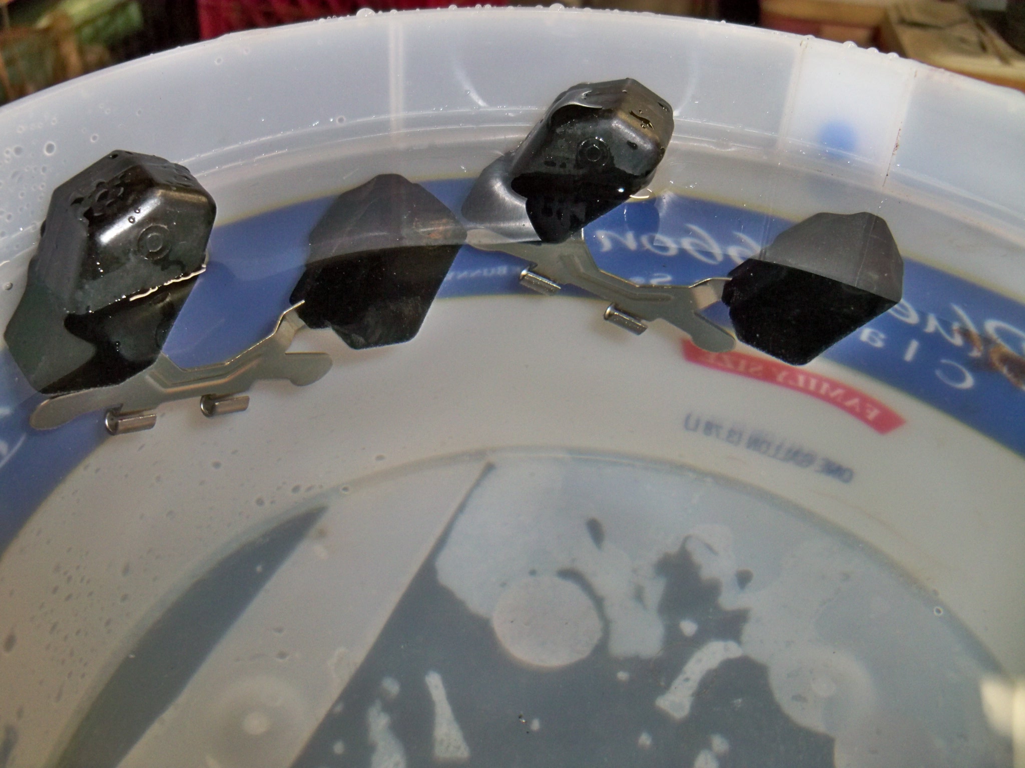

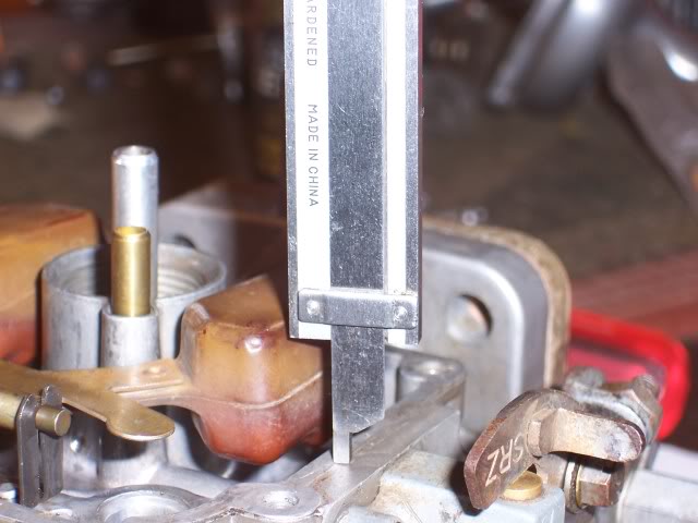

A quick recap: 1975 Triumph TR6
- new coil
- new high torque starter
- 6 new spark plugs
- new fuel pump
- new fuel filter
- 2 new carb rebuild kits
- confirmed good fuel flow to carbs
- 2 new carb floats
- 2 new metering needles and screw assembly
Installed the metering needles yesterday and fired the engine. It started pretty quick and ran for about 5 minutes. I started to initiate the throttle and it responded pretty well. Of course, I had to push my luck and gave it a few good pumps. Not sure if I flooded or starved the engine, but it stalled. I've had no luck restarting, but I can get 1-2 firings. I've adjusted the metering needles both ways and have since brought them back to the recommended 1 1/4 start point.
