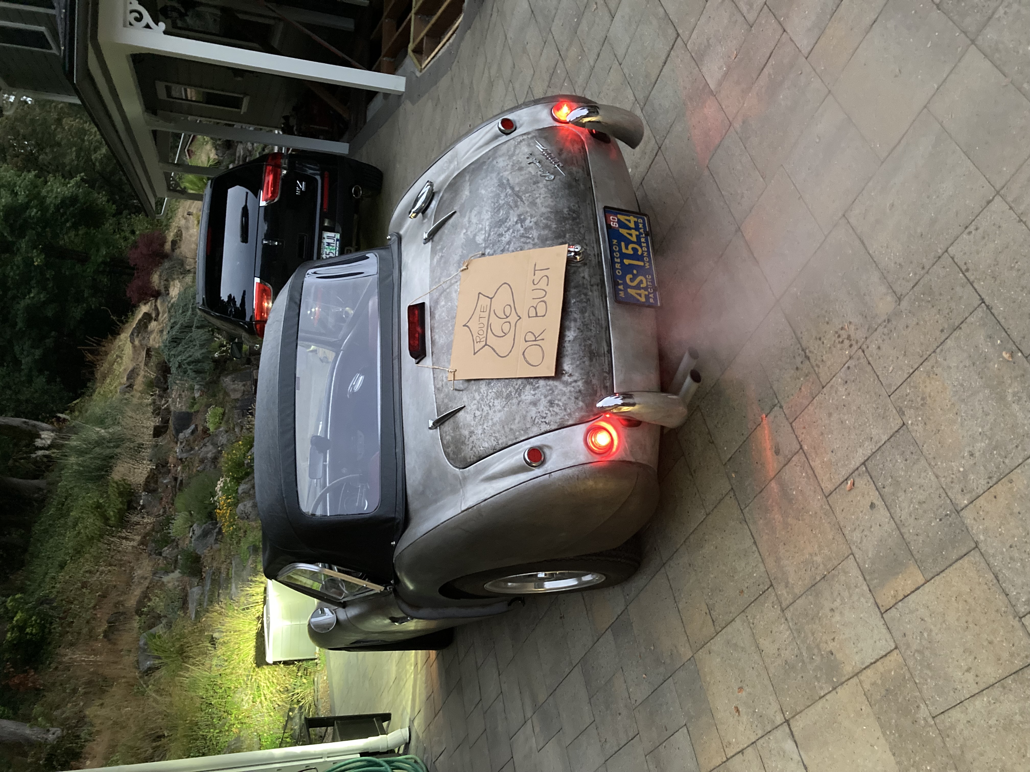

I drove my Healey from Portland to Conclave and now I’m heading down to Chicago on Friday, Sept 20th, to find the beginning of Route 66. Over the next 2 weeks I’ll be driving over what I can find of Route 66 all the way to Santa Monica.
Please join me for a few miles if you can. I have a GPS tracker in my car that shows where I am in real time and where I have been. Just click on the link below.

Very cool and nice of you to offer up. I won't be able to join you on the road but will certainly keep tabs. I'd not seen the application before. Can you post messages like asking for a spare part you elected to not carry in the boot? Healey owners on your route could get you out of a bind with what is likley in storage along your way west. The car looks great.
