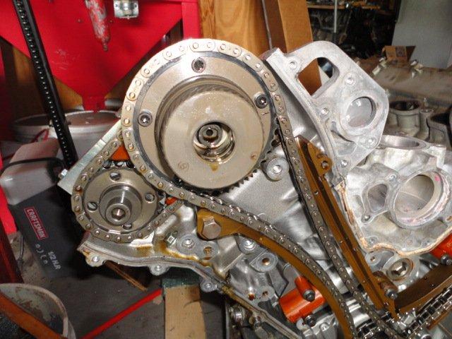

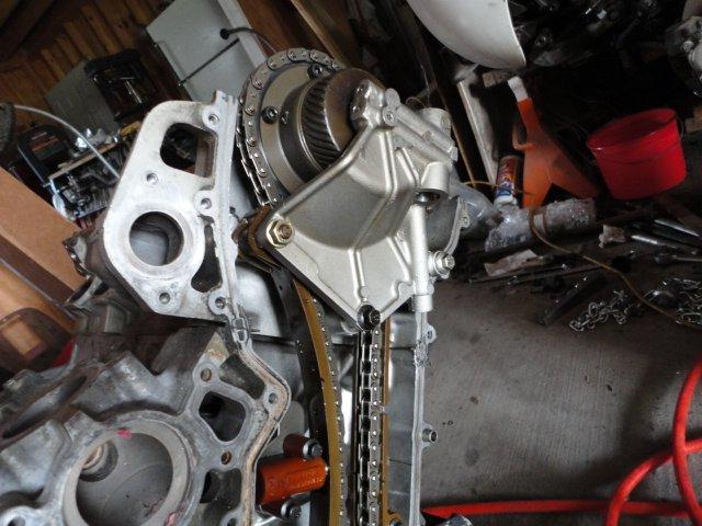

I took the timing cover off the engine removed for the photo in the previous post and to get a look at how the adjustable cam timing works.
In the photo below, you can see that the braket that supplies the oil on the left bank, as viewed from the fromt, is held on with 3 bolts woth 10mm heads.
Opps, wrong photo, the photo above is the r/h bank with the bracket removed. this provides access to the 10mm allen head bolt for the intake cam.
The photo below shows the bracket.

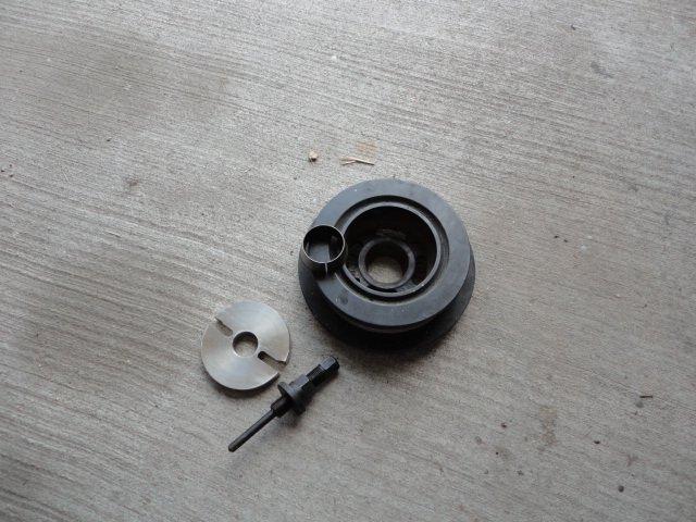

The article said that you had to remove the radiator for clearance toget a puller to remove the harmonic balancer. I had a local machine shop make a 1/2" thick steel plate with 31/32" diameter hole to use with a universal pulley puller from Autozone. With it, I did not need to remove the radiator
In the photo below, you can see the puller, disk, balancer and the split cone. After the bolt that secures the balancer is removed, the balancer tool was installed using two M8 1.25 bolts about 1 1/2" long Balancer came right off.
Diameter of the plate is 3.5". The slots could have been made 3/4" long and 5/16" wide. Place the slots at the edge of the disk. I initially had oval slots and had to cut the outer edge away to fit the bolts. I did not place the slots far enough away from the center.
With the balancer removed, and the bolts that secured the timing cover removed, there was enough room to pull the cover forward to get clearance to remove the bracket from each intake cam gear which gave access to the 10mm Allen Head bolt securing the gear to the cam. The photo below shows the left bank with the bracket removed. Clearance is tight with the top radiator hose and the timinh cover. you might want to drain the radiator and remove the upper hose, but it can be done, as I did with out removing the top hose.

Scroll back up to one of the photos of the engine that I removed. The exhaust cam gear has 4 holes. The holes allow a wrench from the cam chain tool kit to fit and hold the gear while the bolts are loostened. The wrench had a 1/2 inch square to allow a 1/2 inch drive breaker bar to be used with the wrench. You can see this in the photo below.

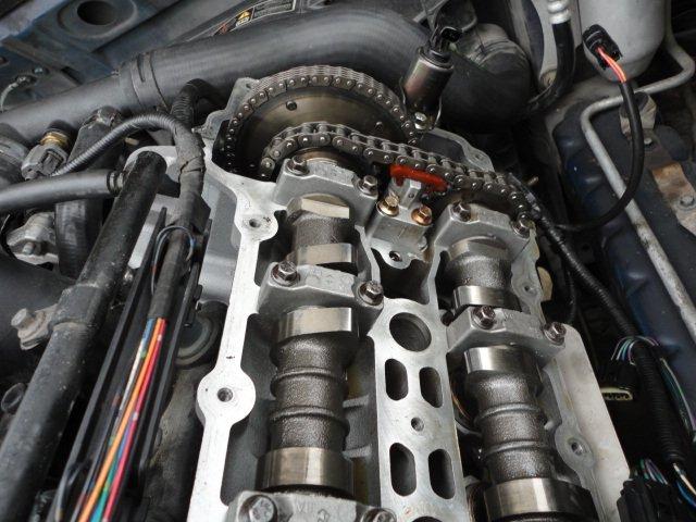

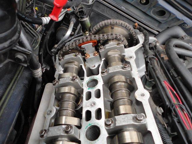

The low compression values on the left bank made no sense.
I went back and pulled the left valve cover again. What I saw was that the intake cam flat was about a half a tooth off.
The only thing I could figure was that the spring loaded chain tentioner depressed slightly when the bolt for the cam sprocket was tightened. I used one of the T-shaped wedges (which are made out of aluminum) to depress the cam chain tentioner before retightening the intake cam spocket bolt.
So, even thoughholding the exhaust cam sproket with the special pin wrench, it must be possible to depress the spring loaded tentioner so that both cams will not stay with the flats aligned.

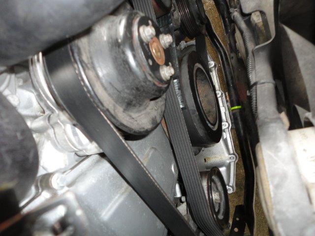

Take a few photos of the serpentine belt routing before removing the belt in order to remove the harmonic balancer. There is no decal showing the routing and I could not find an illustration on the service DVD.
Tahe a few photos of the belt routing because there is no decal under hood that I found showing the routing.

With the wrench installed in the front end of the Intake Variable Timing Piston, rotating the wrench to the left or right will cause about 30 degrees of variation. What you want to do is rotate the wrench to the left side of the car and then check the cam flats for alignment with the pin installed at the flex plate as can be seen earlier in this thread. If not aligned, install the cam flat alignment tool, loosen the 10 mm Allen head bolt for the Intake cam and make tighten the cam alignment tool to lock the flats in the proper position. Make sure that the wrench for the piston is still bottomed to the left before the tightening the 10 mm Allen Head Bolt.
