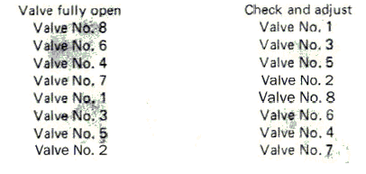

If I cant turn the crank by hand with the fan I have always put it in fourth and pushed it. There is usually a procedure in the manual so you can go from one valve to the next with a minimal amount of turning.
I guess I have always assumed with the plugs out and no compression to overcme it would be easier and that is how I have done it.
Never had much luck with "bumping the starter" not precise enough or I don't react fast enough or something, plus harder to do in sequence I would think, but if it works for you easier than pushing the car I guess.
