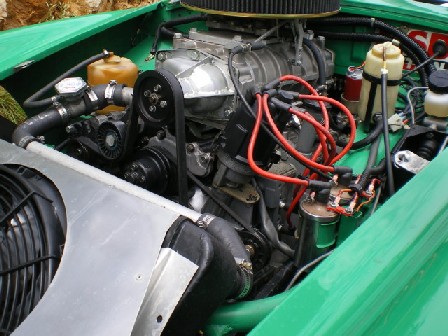

Couldn't post the photo on the other rotary thread, but this is the engine in the rotary Sprite that Tony was thinking about at LotO last year. There is a rotary down under that blower.

Yeah TD, I'm trying to get'er done before winter. It's getting cold here in the northeast. Dave
Oh man that is cool! That thing must fly. I'd love to hear that run. Thanks for the pic. Wondering If I could get one of the to fit? Dave.

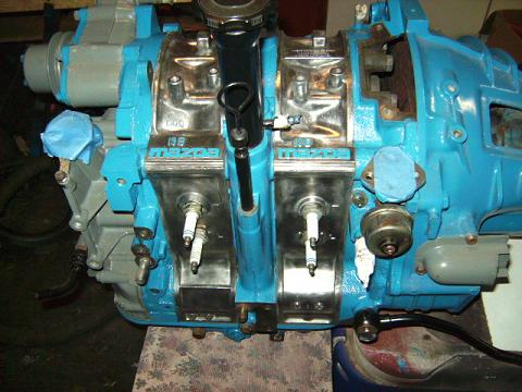

This weekends efforts. Polishing aluminum.

Wow, I don't like the color but that is just me. I like the idea so much.
