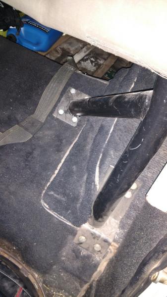

Was looking at my Bugeye the other night and for some reason I ended up looking at how my roll bar was mounted. Would mounting like this allow for a roll bar with the seats you are using?
