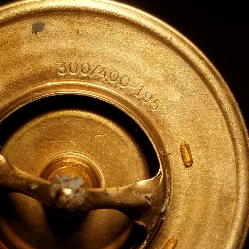

Got a 160 degree thermostat and fitted it today. Not taken the TR out yet to see if that has helped.
I did remove what I think may be a 195 degree thermostat.

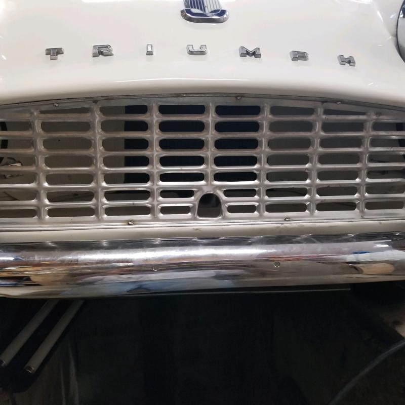

On a side note I did modify the grill a bit. Made a tool so I could gently squeeze the ribs to create slightly larger gaps. It seemed to make about a 5 degree difference. The needle stayed on the edge of the 5 of the 185 mark. The gaps are 0.62" now up from 0.51"
I have another grill that I could have used if the tool did not work.
The openings by the crank hole were not modified.

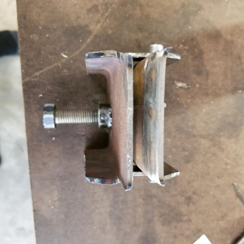

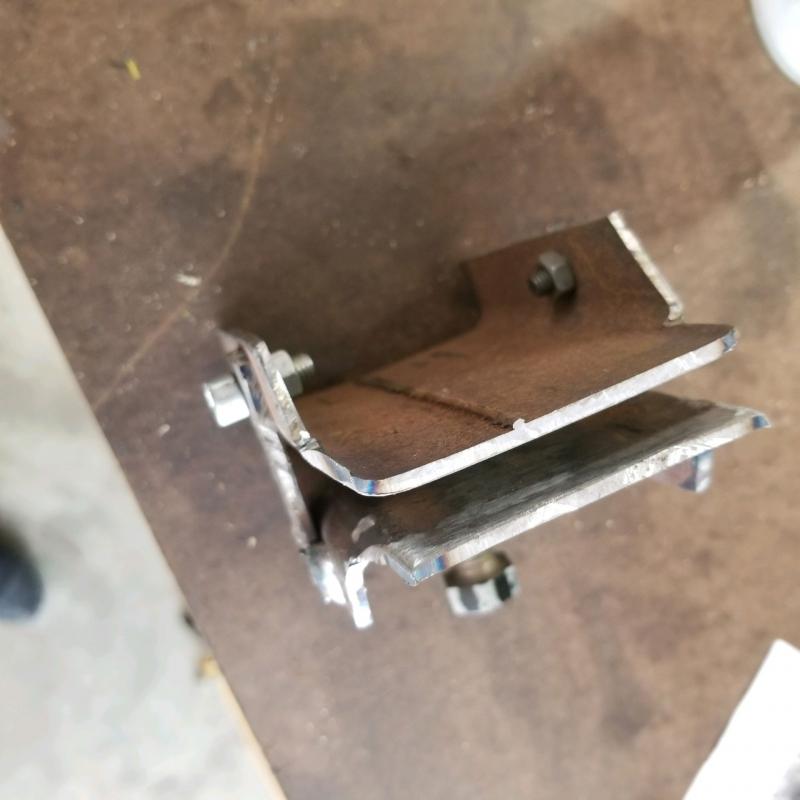

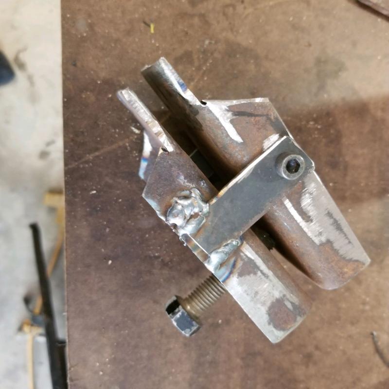

Here is the tool. It is just wide enough to fit the main openings. Just squeeze carefully and check the opening.
Please excuse the welding.
David

That sounds about right. Mine is in there around the 185 somewhere. Sounds like your thermostat was too hot all a long—Good News!—need some of that.
Took me a little while to work out how your grill tool works but got it in the end, thank you David.

Sorry should have posted a photo of it in action.
Once again the pit helped as I could sit down in front of the TR to work on the grill.
David
Well the 160 degree thermostat fixed the problem a bit too well. I am running at 140 degrees now. So I will get a 180 thermostat as I understand the motor should run at around 180.
David
Hello Graham
I think my next step is a trip to Advance Auto or similar for a 180 degree one.
The motor seems to run at the temp . on the thermostat. The old one being a 195 one and was running just over that.
David
I fitted the 180 degree thermostat and now the car runs at 180 to 185. So that appears to be fixed.
