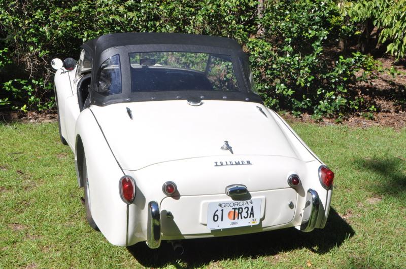

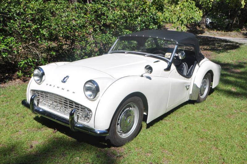

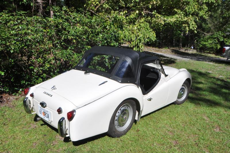

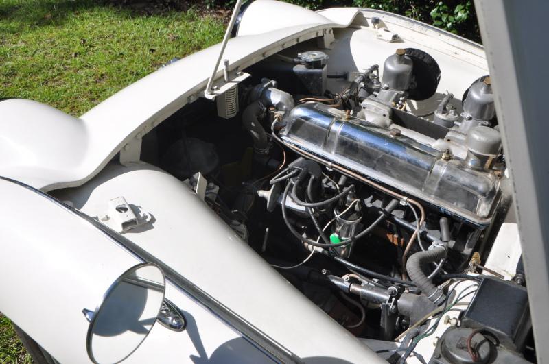

I had intended to post some photos but dd not have any with my good camera,
David
If they are not enlarged and centered it is because it did not work this evening.
TR on lawn.jpgTR front vew.jpgTR pas side.jpgTR wide view drivers side engine.jpgRear view of TR.jpg
David...you have your car on the road but haven't posted pics of the finished girl!?! Let's see her!
David the car looks great and very original. I must be in a controversial spirit and suggest trying a different gauge. It could easily be gauge. I bought a bordon gas tub gauge a few years ago at the corner auto parts store, and I will bet they are line that fit in the dash and the bulb fit into the housing. The gauge was right on, so I guess a second opinion is what I am saying.
