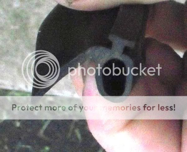

I'm not sure whether this will help at all. Here's a photo of the seal I put in.

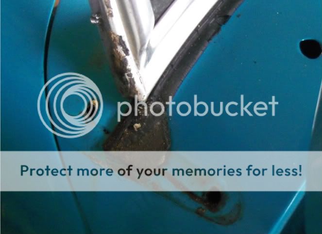

I don't have a photo of the profile, but the link is to the finished installation. The seal that I had previously looked like yours- it touched the wiper bezels.
As I mentioned previously, this one seems to fit the space at the base of the pillars. I think this came from VBM.
This one was incredibly difficult to install. You can see signs of stress (on the rubber, not mine) in the last photo.

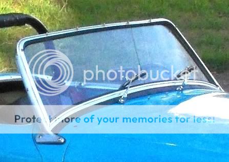

Michael, thanks for posting this. I'm not 100% sure I understand what I'm seeing. The seal looks as if it is curving under the frame. Have you tucked the flap back under the windshield frame? It does look good. Here's a before and after of mine.
Charlie

The photo shows the gasket as it lies naturally- definitely more rounded than my old one. That is the difference between the two types. That's why I was wondering which is correct...
