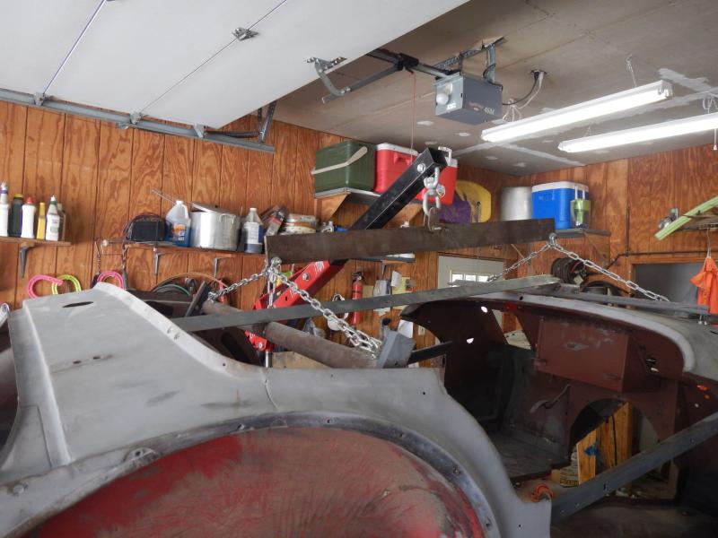

Are the sills the only thing that holds the front and back together? You said the floor has been removed. Have you braced the body to retain the door gaps? The PO of my TR had managed to mess up the door gaps. It took a lot of work to them correct.
I lifted my body using a rig that bolted to the body at the bonnet hinge point, braced to a cross piece between the "B" posts.
David

The bolts are not hard to find, as you say. You must be careful to check the rubber packings to ensure they go back where they belong. Also, the 4 bolts on the front suspension 45 degree braces have aluminum shims which will fall out as you lift the body. I would recommend removing the shims and rubber packs prior to lifting the body, so as to keep track of them for reinstallation.
