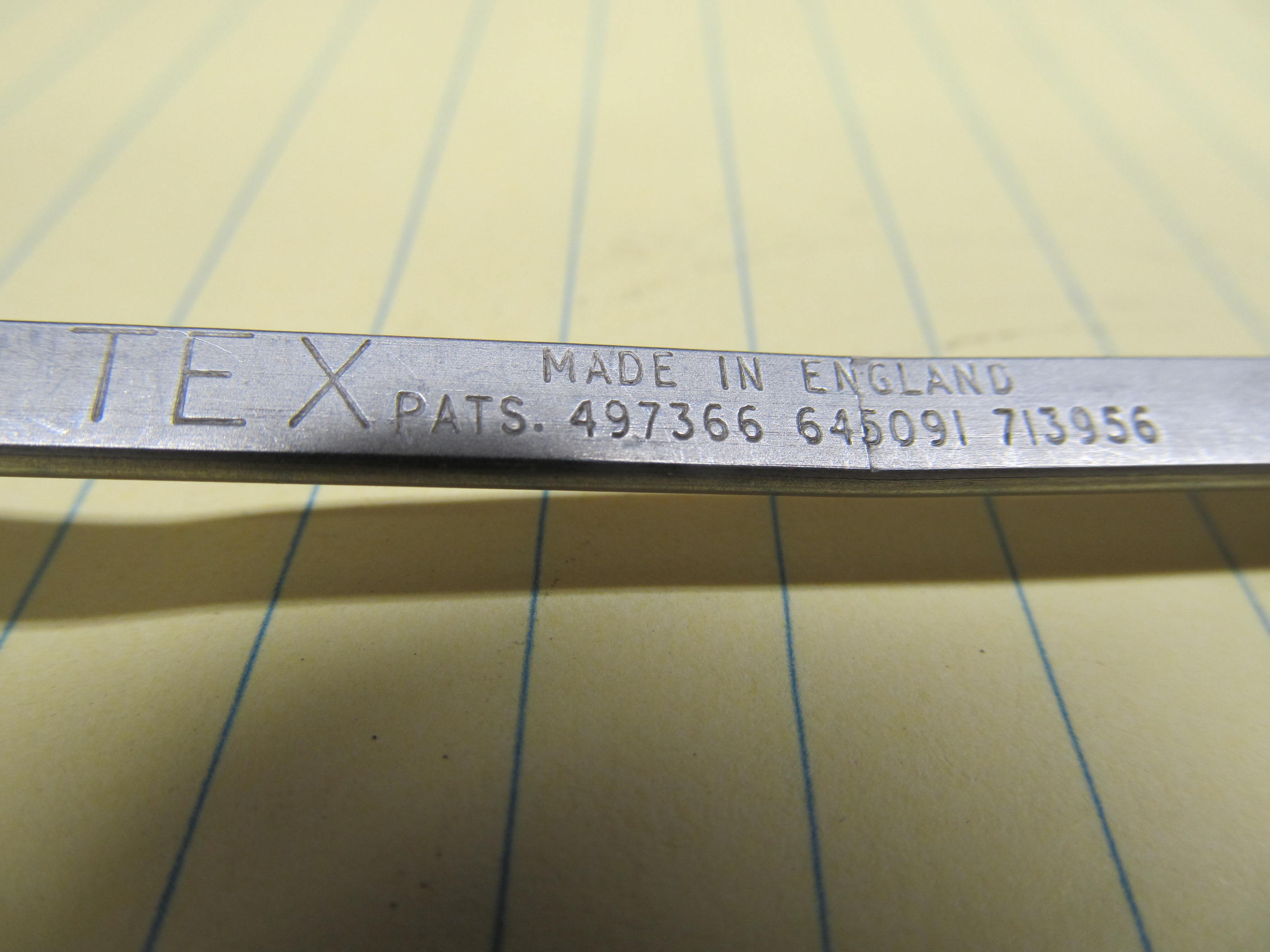

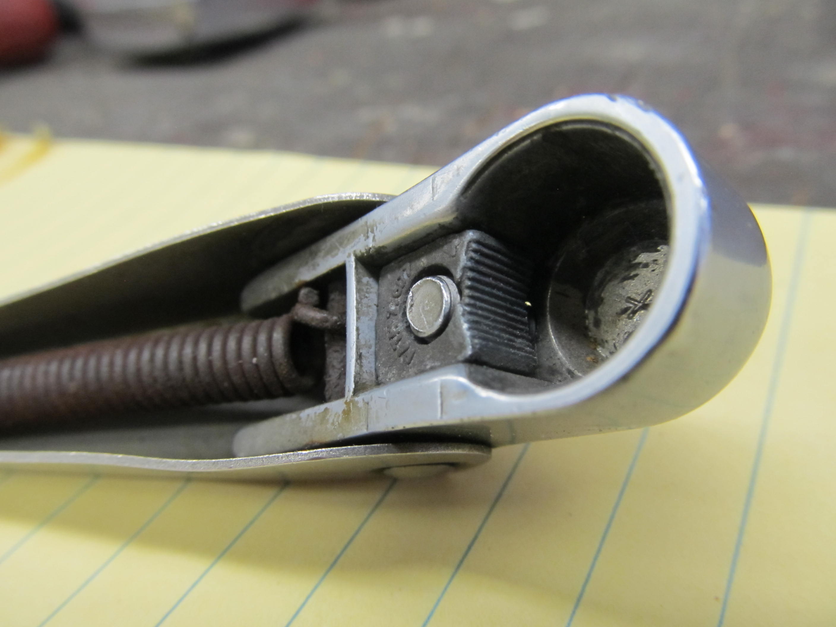

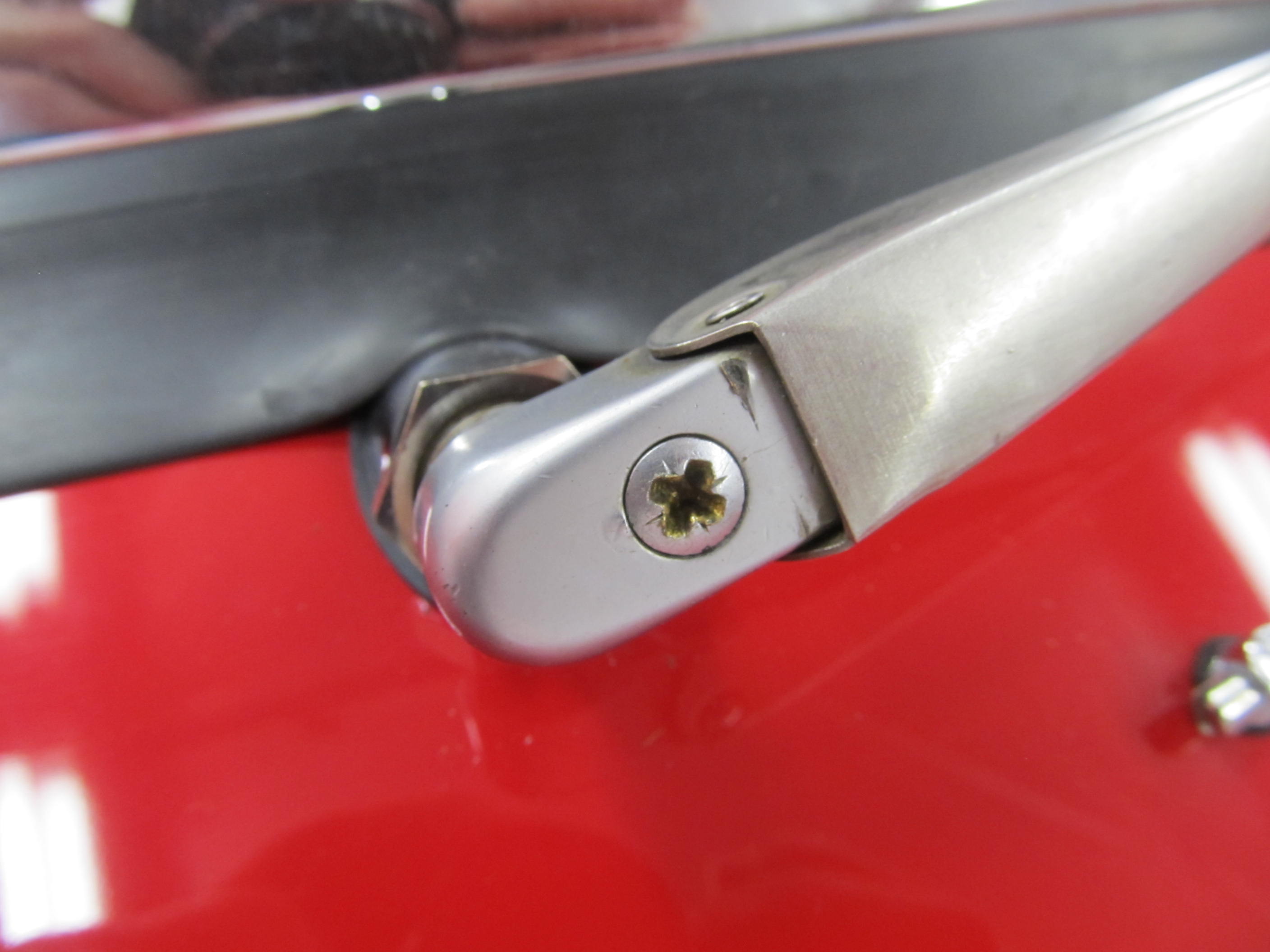

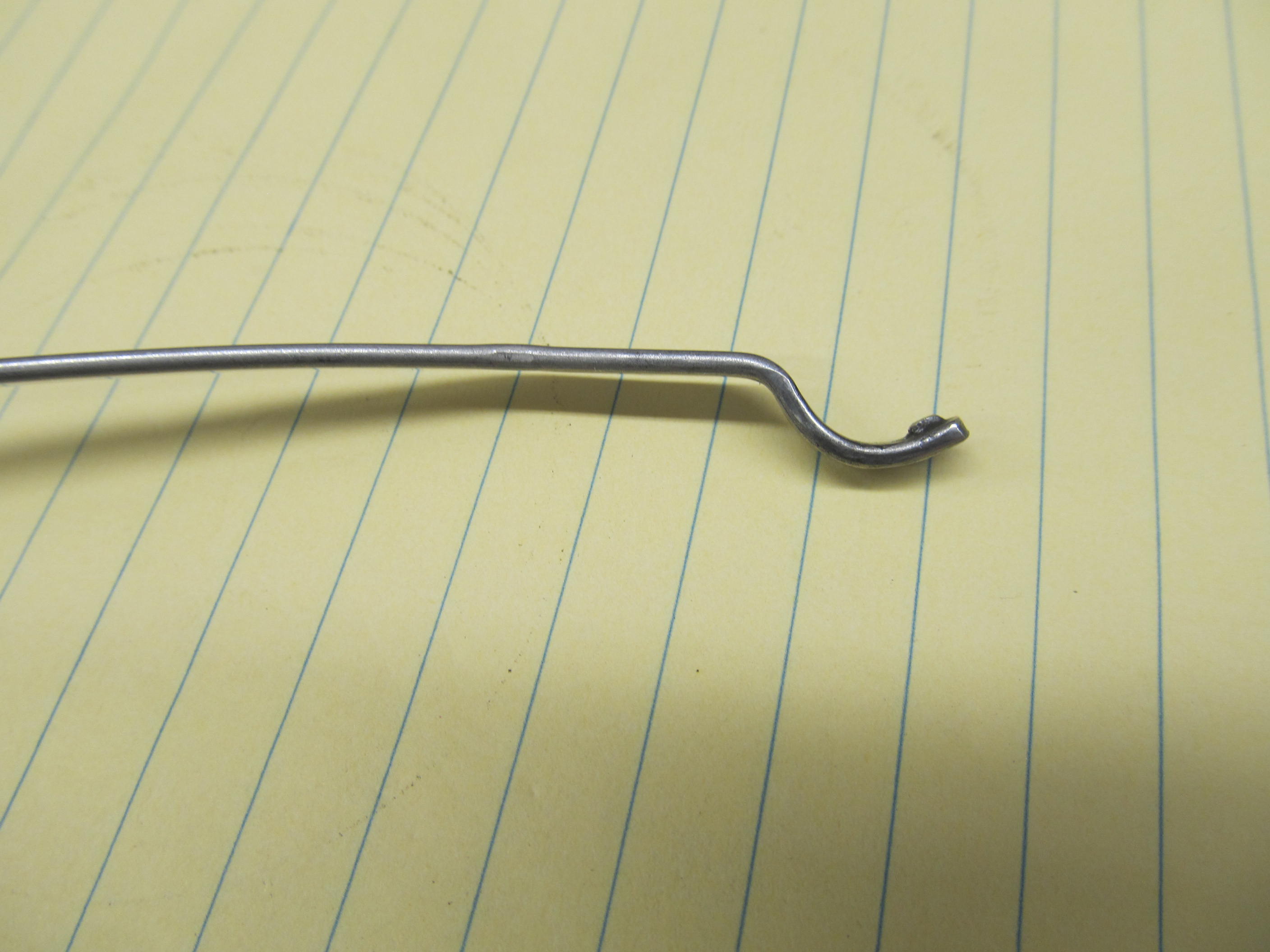

I have a set like DerekJ describes and they are very easy to install and remove/reposition - unlike normal push-on ones, there is no straining involved once you loosen the clamping screw. Mine are TEX brand but I have no idea if they are OEM or aftermarket. They also have a very simple hook shaped spoon at the outer end for attaching the blade. Another advantage of the clamping system is the splines don't wear and allow the arm to slip. I heartily recommend them if you ever find some.
