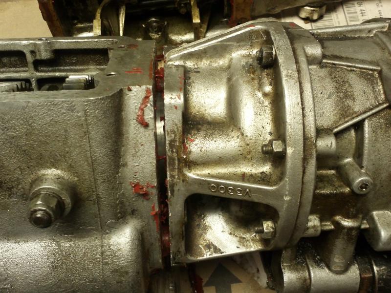

Trying to separate the overdrive unit from the rear of the gear box. Took out all 6 bolts and a ton of RTV silicone. I can only get it to move about a 1/4 inch. See pic. I can see some one has been in this several times as there are many screwdriver pry marks. I have no instructions so it may not be as straight forward as it looks. My goal is separate the two and get the main gear box cleaned up and inspected. What am I not doing?

Did you relieve the bind between the direct drive clutch and the sprag clutch? (Shift into and out of OD with the clutch depressed.)
You can download instructions (as part of the TR6 workshop manual) from
https://drive.google.com/file/d/0B2H2NJt34OffZTJaeXJhWllGWnc/view?usp=sharing
The bit mentioned above is in section 40.20.07, removing the OD from the car. Disassembly is right after that.
Well, normally that joint should just pull apart. The clutches binding is one reason it might not. If it is the clutches, the only ways I know to get it apart are brute force, or fill it with oil, spin it up on the bench, and hit the solenoid with 12v. In theory you could just pressurize it through the test port, but I don't have an oil gun that will generate that kind of pressure. You can read through https://www.buckeyetriumphs.org/technical/jod/JOD2/JOD2.htm for some other ideas.

Well I think the Triumph gods did their magic while I was sleeping. The next morning I was able to walk it of fairly easy. Got to wonder how many times this thing was apart, you should see all the pry marks from probably screw drivers and the RTV silicon. Wow! The oil passages were even blocked so the OD could not have been getting a full oil supply. I took the main case to one of my customers and they let me use their enzyme parts washer to clean it up before disassembly. I'll make sure it's tip top shape before I start on the OD. If I find too much bad I have a old Volvo J type OD that I hoping to use for parts or maybe just swop out the speedo gears and use it. I know it is good but not used for 12 years.

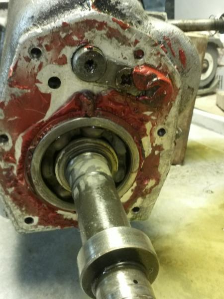

Ok got the input shaft out and then the lay shaft but the layshaft gears won't drop out of the way(so what do I do) so I can drive the main shaft out of the rear bearing. My concern is damaging the gears as I hammer the shaft towards the front. The cage for the needle bearings in the input shaft had disintegrated and that was a bugger to get out!
If you do hammer the shaft out, plan on replacing the rear bearings. Best to press them out.
For sure he are getting replaced. They seemed a little rough anyway. Looks like I'll be bushing the gears too and what ever else I find in there. Only planning on doing this once.
That big screw and plate at the top of your photo is holding the counter shaft in place. Remove that, then you should be able to push the shaft out from the other end. ISTR it's helpful to push a dummy shaft in (which is too short to engage with the case and stays inside the gears, but I don't recall why offhand.
With the shaft out of the way, the gears should fall to the bottom.
PS, a warning for later : All of the bushings I bought turned out to be the wrong size in one way or another. That was a few years back, so maybe not a problem now, but check them carefully. Out of 4 bushings, 3 were too short and the other was too small on the inside diameter.
Oh, we're talking tranny! I was still focusing on the OD. Did you get the layshaft gears to drop yet?
Randal I do have the lay shaft out. The info says and a video I watched you can hear the lay gears fall to he bottom of the case once you pull the shaft out. Ive tried taping the gears and dropping the case. The gears only moved about 3/16 of an inch. For what I can see through the layshaft holes the thrust washers look badly beaten. (like the rest of this tranny) so I wonder if they are holding the gears up. What if I was able to push the main shaft up as high as it will go, support it in front of the main shifter selector with shims resting on the inside of the case, then turn the case upright and press the shaft out of the rear bearing so not to damage any teeth?
Hmm, my memory isn't exactly clear, but I don't think they dropped much more than that.
Not sure I follow you about the shims, but the usual way is to remove the rear bearing with the shaft still inside the housing. You tap the shaft to the rear just enough to get a bearing separator under the circlip, then either use a puller to get the bearing off the shaft, or put shims under the circlip and then tap the shaft through the bearing (repeat as necessary to work the bearing out). Page 7 at https://vintagetriumphregister.org/maintain/TransRebuild/TRTrans01.pdf shows the process using what I believe is a cheap separator from Harbor Freight with some simple mods to increase it's reach (threaded rod & long bolts from the hardware store).
If you really can't get the cluster gears to drop, then you may be able to get a pry between the back gear and the bearing, to move the shaft forward a bit and then drive it back as above to work the bearing loose from the case. Be careful though, and stop if the gear teeth get tangled. You don't want to break the gears.
Yet another approach might be to use a small grinder (eg Dremel) and grind the bearing apart. Cut the metal bands that hold the balls in position, then grind notches into one or both races so you can remove the balls one at a time. Very tedious and time consuming, but should be possible. Be careful not to cut the case or shaft (although one or two small nicks won't hurt anything). (I've done other bearings this way, never had to use it on a TR though.)
