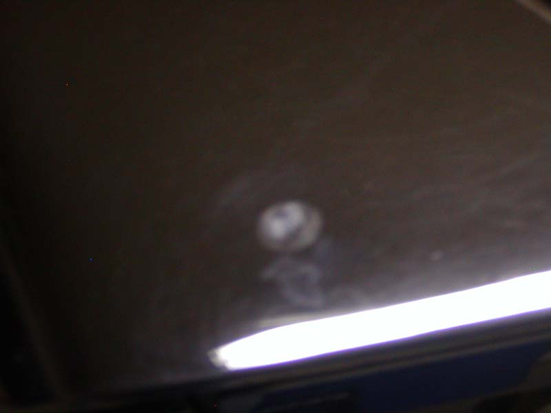

Okay, now I think it's attached. Not the greatest shot.
The spot is about 1/2" diameter.
Autofocus cameras can get confused when you’re shooting paint defects. You can trick the camera into focusing on the surface by putting something in the frame, on the surface that it can focus on.
A coin usually works well, as does a fingertip.

When you used the SwirlX, what was the result? Did it reduce the look of the damage or just make it shiny?
Same with the compound, what did it do? Was the damage pattern less visible? Was it shinier? Hazier? Did the compound actually remove the pattern and then leave a "cloud?" Was it better? Worse?

Trusting my memory, I think the swirlx helped the most. It reduced the sharpness of the spot, if that makes sense. Next I tried the rubbing compound and I don't think it helped much.
Either way, one of them helped. I'm just wondering if there is something better, or if I just need to use more elbow grease?
After it happened I read a little on the net about this, and there was a diagram and explanation that sometimes the chemicals penetrate into the clearcoat layer. If that's true I guess I may have to polish down some of the layer. I just want to make sure I don't make anything worse.

It’s true, bird bombs can sometimes disrupt the film too deeply to repair. In those cases you just attack it however gently or aggressively you’re willing to try and live with the results.
Even in the worst cases I’ve seen, you could still reduce the appearance significantly, usually to the point where it was sort of an optical distortion with a few microscopic pits rather than a big cloudy patch.
But that’s been severe cases. More often than not, you could remove them either completely or to where nobody who wasn’t looking for it could see it.
The SwirlX you used is a really mild product. It’s meant for pulling out very fine scratches and swirls. You could keep going the way you were for a very, <span style="font-style: italic">very</span> long time without any fear of overdoing it. So if it was making noticeable progress maybe you do just need more elbow grease.
You’ll also get a bit more cut if you switch from microfiber to 100% cotton terrycloth.
If you want to step up to more powerful chemicals but still keep in the goof-proof gentle zone you could try Meguiar’s ScratchX 2.0 or Ultimate Compound, either by hand or DA buffer.
