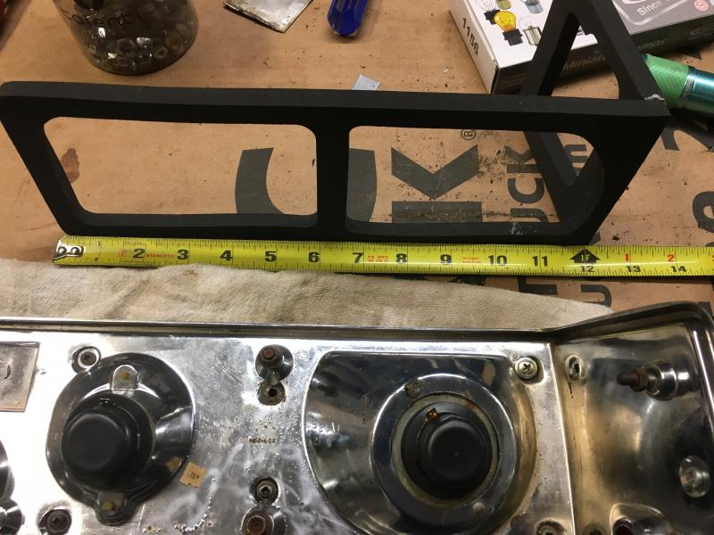

Can anyone recommend a decent gasket for sealing the tail lamp assembly to the body for a TR6? The one I received is a terrible fit (see pics), requiring a LOT of stretching to get it anywhere near where it needs to be. Alternatively, has anyone tried making their own, perhaps using a round foam cord? Thanks for any advice.

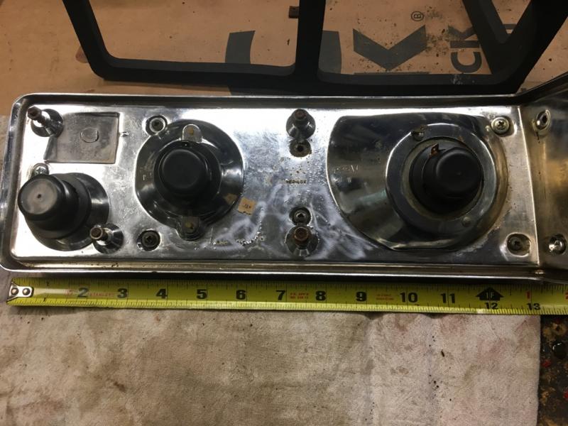

The assembly itself fits pretty nicely with just a little bigger gap right at the corner. But the new replacement 3/8 thick gasket seems to have shrunk like the waistband on my trousers. See the attached photos... gasket almost an inch shorter across the rear facing part than the fixture.

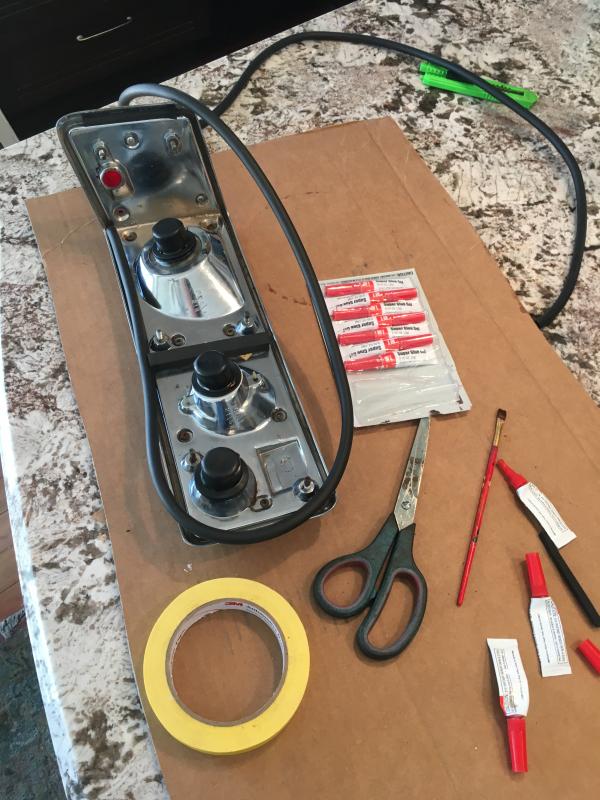

Thanks for the ideas. I’ve cut one from a flat 3/8 sheet but have yet to tackle the round outside corners. I’m also thinking the 3/8 foam cord would be much easier to deal with if i can find a contact cement that will hold it in the channel while I attach the assembly to the body. That’s what I’m trying tomorrow.

All done, could not have been easier using the 3/8 diameter EPDM foam rope. Ten feet from McMaster-Carr for $6, plus a ten pack of super glue from HF for $3.75. Each lamp assembly took a few minutes to glue down the rope in one continuous piece. To be safe I taped the corners down with masking tape until just before I installed onto the body. I laid a bead of glue down in the channel and spread it a up the sides of the channel with a small brush. The glue sets in a few seconds. This is the same type of foam used in automotive door seals, I think. Super glue is the best adhesive to use, in the gel form. Clean up with acetone.

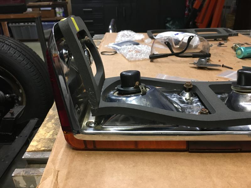

I used a piece of the 3/8 sheet foam to bridge across the middle of the rear part of the fixture like the stock gasket and added a little length of foam under the cord at the front edge of the side marker to push it out more toward the edge because the channel gets much wider there. Might even consider using the 1/2 inch foam if I had to do it again. Can't remember if they sold a 7/16 diameter cord.
