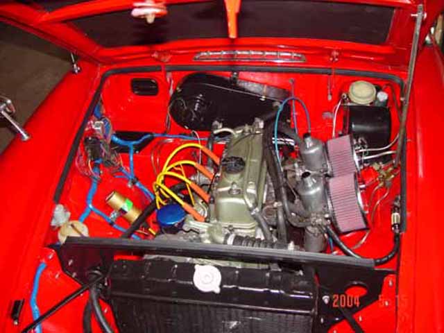

Since you've gone this far, why don't you go ahead and strip the engine bay and get it painted body color. It looks like your really going all out, take that extra step now is the time to do it. It's not too difficult (except for the heater box) and REALLY adds to the value of your B.

Here's a photo of my bay, the first time I stripped and painted it.

Cool! It's gonna turn out great!
I was just concerened when you said you had "nothing left to do". I hate when I see a beautifully painted car and under the hood it looks like crap.
