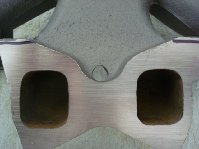

I want to install a rear lift bracket on my 4cyl engine but I'm not sure of the exact way. I'm thinking this is how it is mounted. Would love to see a picture of the correct way, or some information would be great. First picture is how I think it may go.

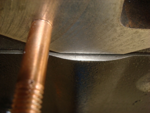

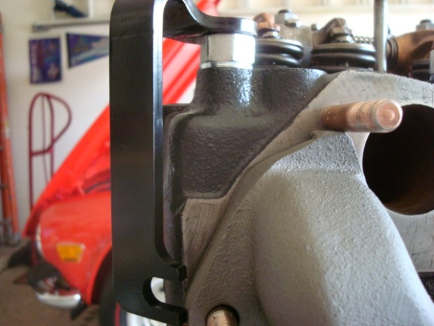

Second picture is something I found while trying to trial fit the bracket. The PO did shave the head in the past, and I had it shaved to make sure it was flat. I do not remember the exact measurement of the height of the head, but it does not exceed the maximum amount that can be removed. The problem I found is the the exhaust manifold will hit the side of the block before it seats to the head. I realize that the gasket will take up some of the clearance problem, but it looks like I will have to remove some material from the bottom of the manifold. Second picture.
Having never rebuilt the Triumph 4cyl before it seems to have a few more quirks than the 6cyl.

This is where the manifold will hit the block.

I can't snap a pic right now, but I think all you need to do is get it under the nut on that last head stud, I think with a washer. Kind of a dumb design if it was on my engine correcly - you actually have to loosen the head stud whenever you want to pull the exhaust manifold.

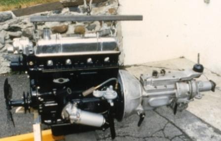

Fer cryin out loud, these pristine engines are making me feel a little embarrassed for mine which is coated in authentic, vintage oil and road grime! Beautiful job Frank, as well as the one you have there Keith - looks like you shop at the same manifold paint store too!

Thank you Frank that is just what I needed. Very very nice looking engine. Where did you find the asbestos carb insulators? All I can find are the black ones.

Worth noting perhaps, that the lifting eyes were not left installed on TR2/3 motors (until the TR3B with the TR4 motor). It was only a tool, to be installed only when needed.
On the later engines that did have them permanently installed, the associated studs got longer to account for the increased thickness.

If you do not have the lift eye installed it has been suggested that a large washer under that nut (and it's counterpart on the front stud) may help spread the load a bit and reduce the chance that corner of the manifold will break. Given the source I immediately added said washers.

I added flat washers as well, mostly so the lock washer wouldn't tear up the manifold.
Randy thank you also.
Actually, I found those in the early nineties when I lived in England. If memory serves, I found them at a boot sale with a bunch of other non TR stuff.

Thanks Scott, Randy, etc. Now if I can only get this finished. Man, it's been so cold. Brian hasn't been able to paint, just too cold for reliable results.
Thanks for the information, I think I will install it and leave it there.
