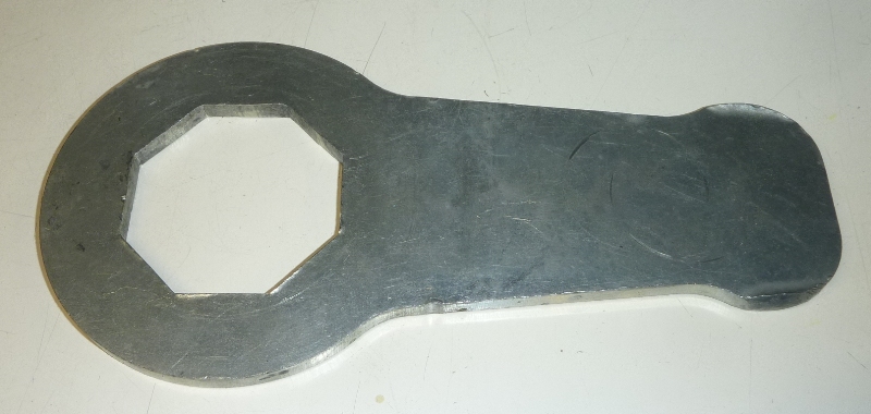

I bought this wrench from Healey Surgeons for around $50 - 10 years ago.
I don't know about 150 lb ft. When you tighten these nuts, they just come to a stop and refuse to budge more. This wrench is made to be hit with the lead hammer.

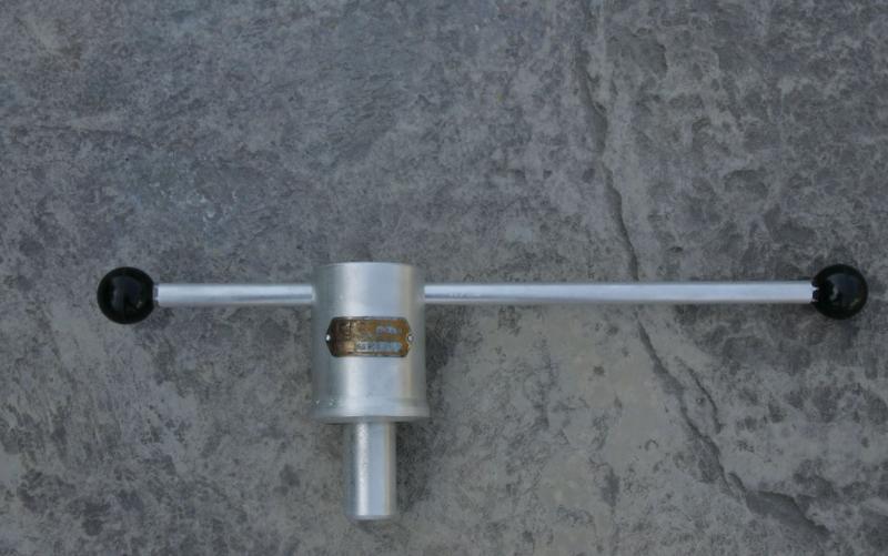

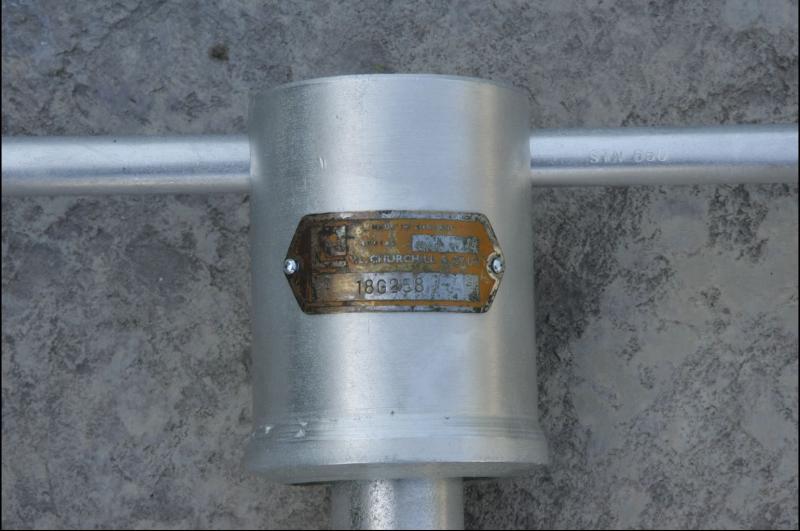

Steve,
I saw an original 18G258 on eBay a few years ago and just could not pass it up. I've seen a few for sale since, they seem to sell in the $125 - $175 range.
Your welcome to borrow mine anytime!

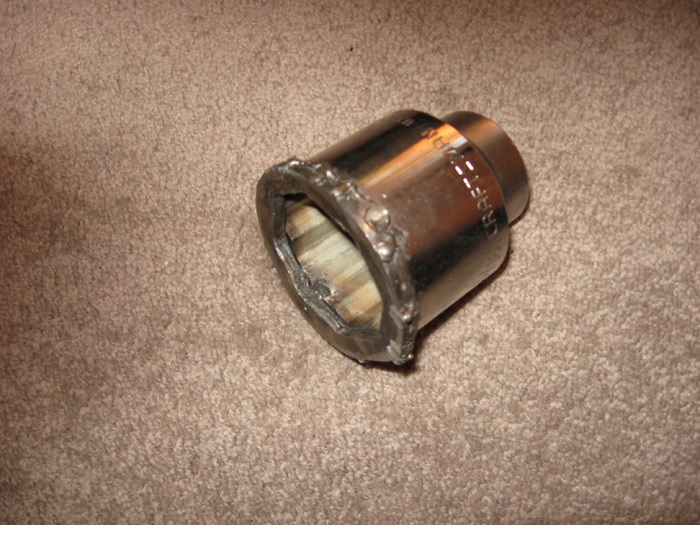

I made a special tool from a Sears socket. Not exactly pretty, but it does the job. Actually, I put together a tool kit and instructions for removing and installing the rear bearings. It's available for loan for the postage.

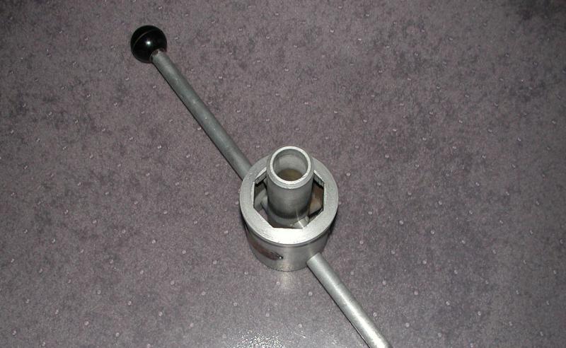

The spanner socket I bought years ago--similar to the AH spanner--has a 'strap' for a half-inch torque wrench, ratchet or breaker bar, and holes for a shaft like the 'official' tool.
