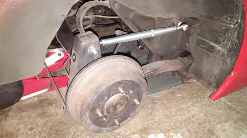

Okay, I'm feeling a bit bad about asking this, but is there a trick to getting this drum off? I took out the two bolts and that sucker is on there! I went around the circumference of the drum and tapped it with a hammer to break it loose, and nothing, it won't budge. There is a very small recessed phillips head, but I don't recall that holding the drum on. Tips?

Looks like everything is off that would hold it on, does it rotate? The parking brakes not on is it? I like to use a BFH, rubber or plastic and hit it from the rear while using a big screwdriver to pry it off.

Yes, its spins freely, braking brake is off. I was prying it a bit between the drum and the backing plate, but no movement. Maybe I just need to be more aggressive with it, and a BFH
The recessed Philip's head hold's it on. Or rather a 'pozidrive' screw. Also loosen off the brake adjustment plenty.

and it is likely `rusted`lightly to the hub - hit it harder
and I hit it harder, that was the remedy. Turns out its rubbing as suspected. I hit the drum with the bench grinder, helped, but not consistent enough. I'll take to to a machine shop and cut a millimeter off. Thanks for the help!
