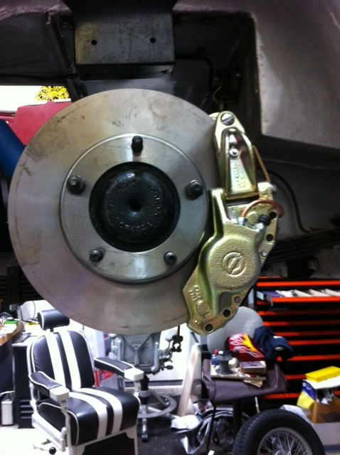

If anyone's interested, my rear disc installation is almost ready for the first drive.
Photo essay:
https://www.pbase.com/stevegerow/healeyreardiscs
Photo essay:

No Booster on a full disk setup? I appreciate that you are doing slow speed testing and will be adding to the installation before going faster but I was under the impression that disks with ceramic pads would require additional force for cold low speed stopping. Could it be that the master cylinder you have chosen produces the additional force needed? I am really impressed with the look and initial results of your preliminary test .... good job.

How does the emergency brake function on/with the disks?

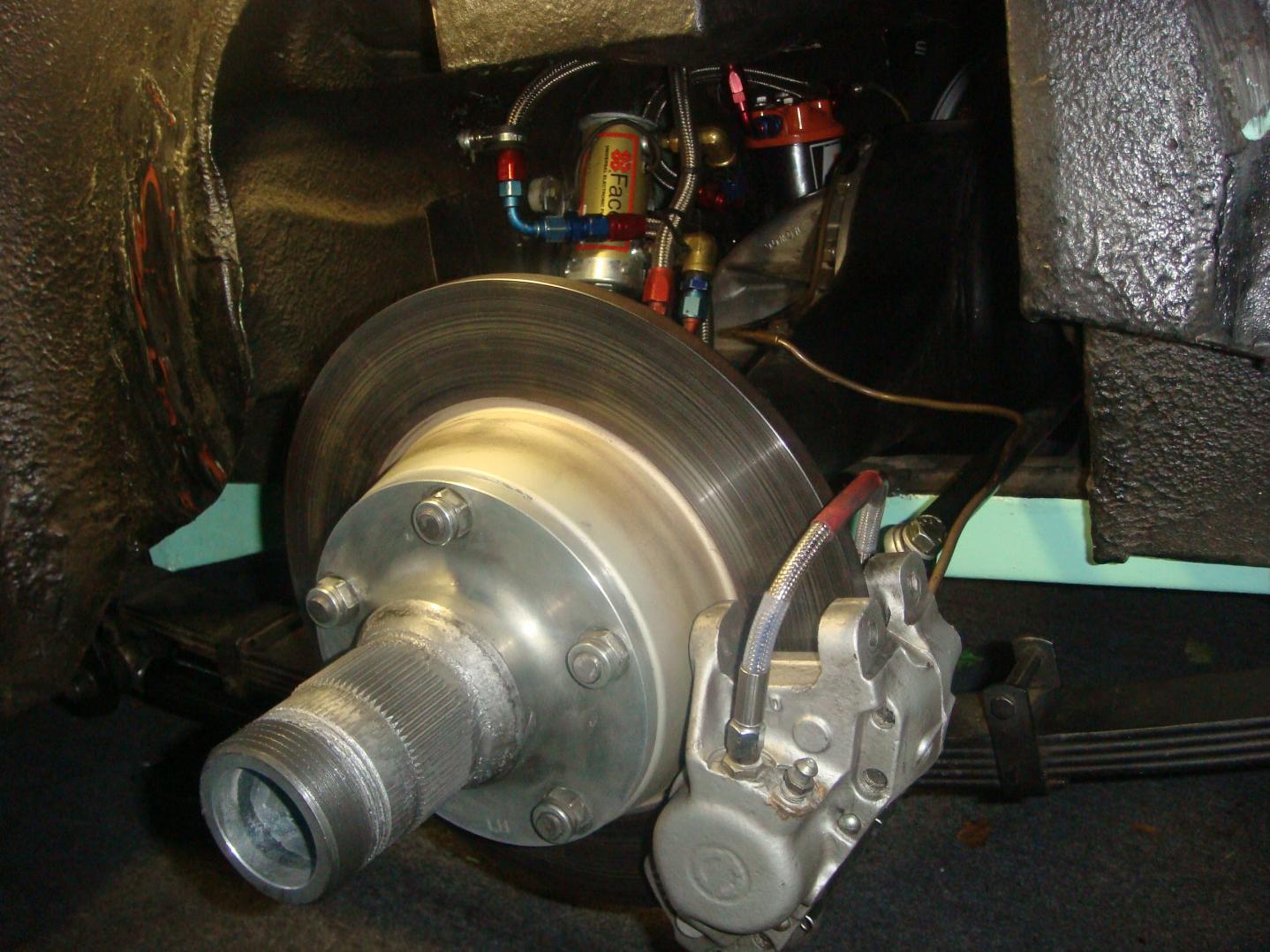

My set up is Denis Welch, so I can't take the credit that Steve can.
The Nissan MC seems to be doing just fine. One of the things that also helps is the choice of pads front and rear, based on advice from Denis. I would have to go back through old files to find the type of pads, since they were installed ~10 years ago.
Without doing what Steve has done with the bracket, or some other change, the p or e-brake doesn't work.
