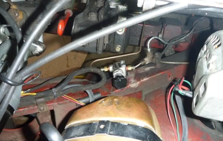

Installed proportioning valve inline between the 5-way and rear brake line:
As was suggested we began by doing a "jackstand" test. The "dreaded assistant" put slight increasing pressure on the brake pedal as we turned a front and rear wheel, adjusting the prop valve to find the lightest-pressure-position where the front wheel locks and the rear wheel has braking drag but can still be moved.
Then did the road test and found the car stopped straight with no fishtailing on the panic stop.
It appears the proportioning valve, by decreasing rear braking, increases the pedal pressure required, though not by a large amount.

Ray,
They're Toyota 4-piston fronts on late BJ8 swivel axles with the thicker late BJ8 discs. See:
https://www.pbase.com/stevegerow/healey_discs
The stock disc drum setup has either smaller or larger (forget which) rear wheel cylinders than the all-drum cars. IMHO this provides a proportioning effect.
I don't know the answers to the drum technical questions but the 4-wheel disc setup stops in a shorter distance than the disc-drum setup did. The proportioning valve is necessary to tune the rear brakes to the fronts. The fronts are left at full strength and the rears are dialed back until the rear doesn't skid any more during a panic stop.
I adjusted the proportioning valve for severe stops. The car stopped straight enough in ordinary driving but was pretty exciting when I did a panic stop pre-proportioning valve.
If the front calipers are less powerful, one would have to dial the rears back even more, resulting in less braking power over all.
The Richard Mayor (Boyracer) discs are 11.25"D vs 11" on the Denis Welch and Cape International. The difference shows.

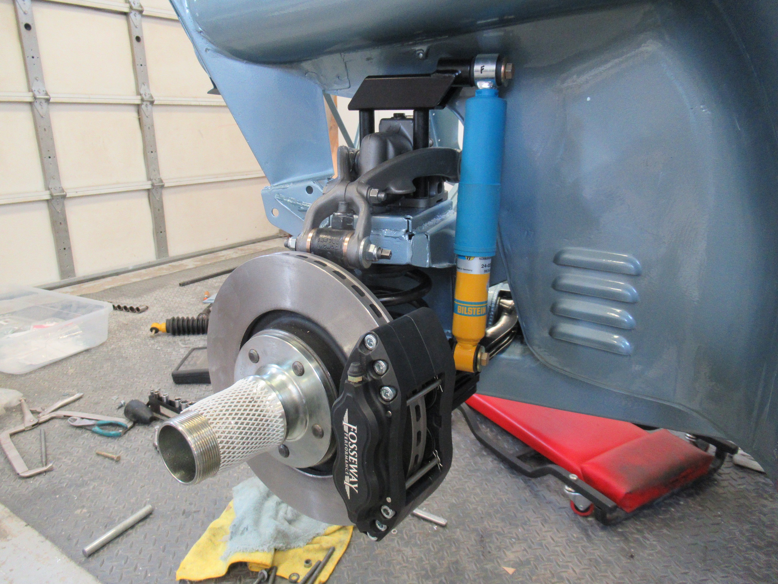

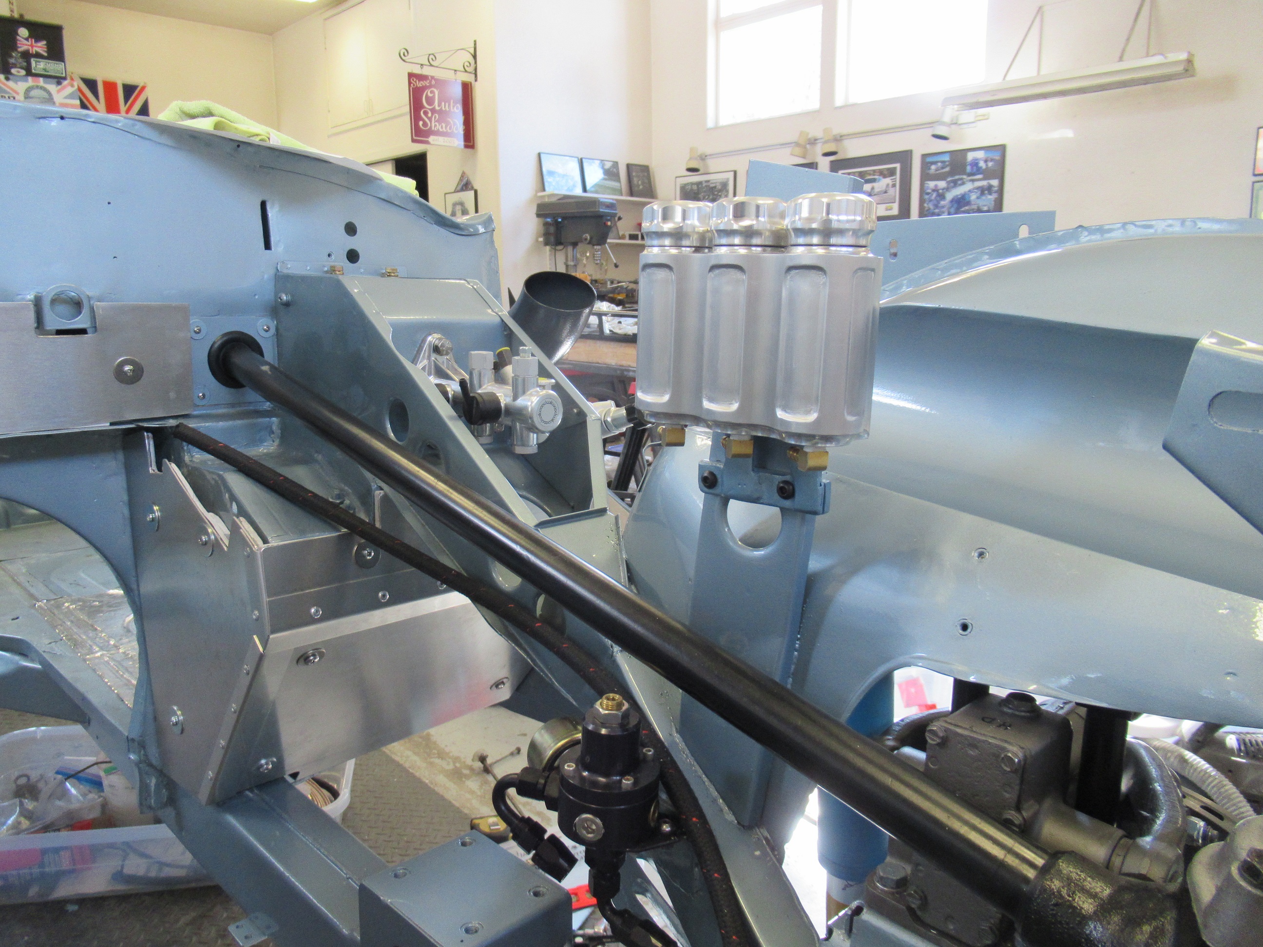

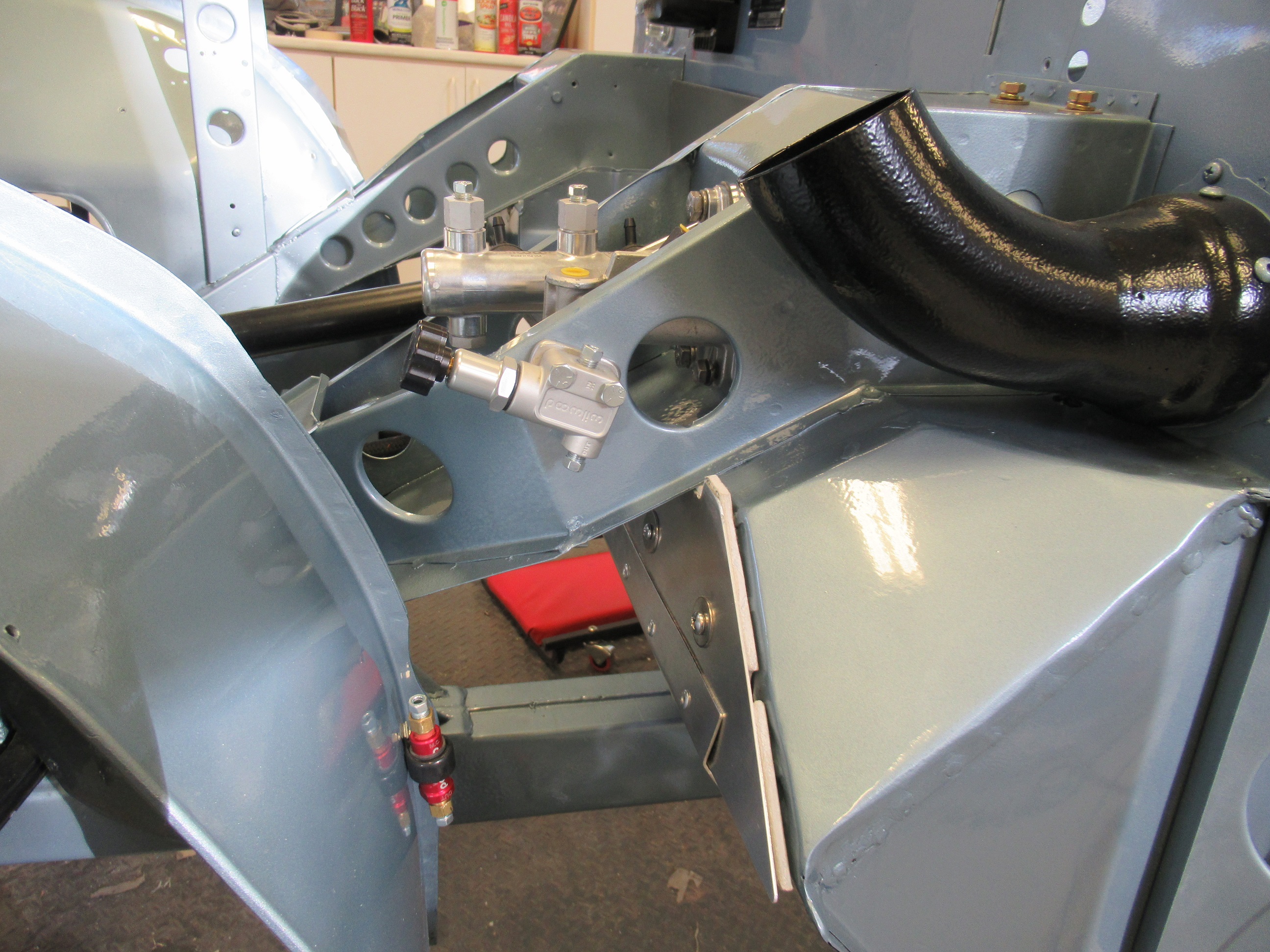

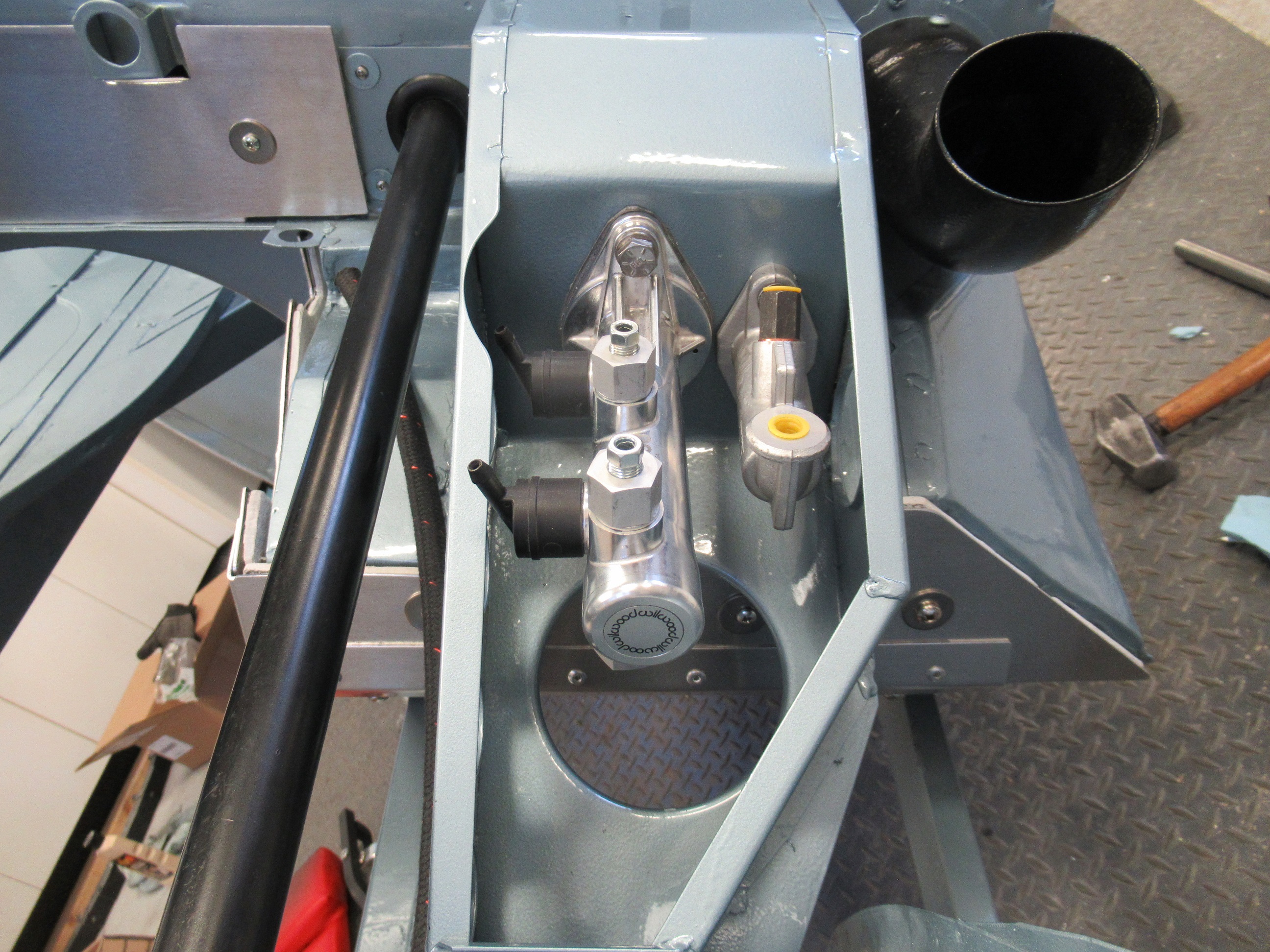

Steve, I will be interested in your efforts with the proportioning valve. I've just installed one on mine... but I'm a long way from actually testing it. I'm changing everything.... as any self-respecting obsessive-compulsive person would be expected to do.... Wilwood dual master cylinder, prop. valve, residual pressure valve, triple remote fluid reservoirs, Fosseway 4 piston cals., etc. ..
